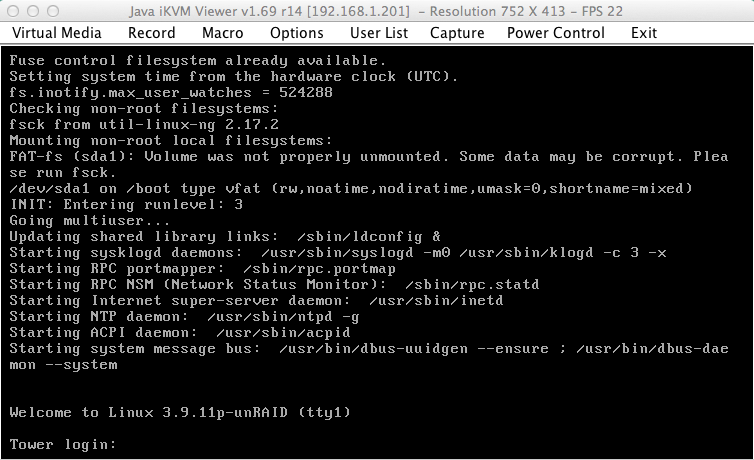

MY server has 9 x 3TB WD Reds drives, I only have the APC Script, Dynamix and Dynamix System Temp plugins installed. My system has no Parity at the moment as I'm waiting my new LSI 9201-16i card to arrive any day. It has been working great and I have now finished copying all my Media over and reorganising things. However this morning I could not load up the Dynamix WebGui or the iPhone app Margarita To Go. In the end I had to login to my IPMI and use the "powerdown -r" command to reboot the server and it gave this message on reload. Im using unRAID 5.05. Stability is a concern here. What do you recommend I do. Attached is my IPMI View Screen after a reboot using the powedown -r command.
Looks like your flash drive "sda" has a problem and you need to shutdown, pull it, and take it to a Windows box (or Mac but command is different - but no idea what it is) and run a chkdsk on it.  Then put it back in your server and turn it on.  Then see if Dynamix and other plugins work.

In OSX what you need is Disk Utility. It can correct FAT/32/extFAT filesystems.
Thanks Guys, I took out the flash drive and run a repair disk on it with my mac, hopefully it will sort out the issues. I will let you know if I have any further problems.
Can someone offer some advise please. I have run disk utility repair permissions with my mac on my SD card and Im still getting this error on a restart. Is this what I should be running.
