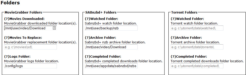

what does your folder settings look like?
attached

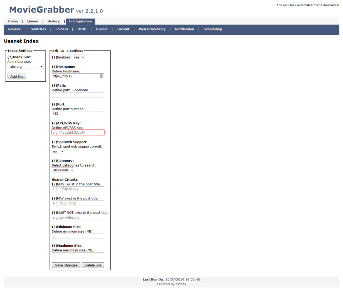

NP OK I see the issue straight away, you have no search criteria, try entering something like 1080p,bluray into the must exist search criteria save and then run now
isn't the hostname for nzb.su  https://api.nzb.su
Thanks for this eroz, It used to be http://nzb.su/api if this has changed then for now Justinchase will need to create a custom site (in Usenet section) and fill in the correct URL.
Please let me know so I can change the template if required.
Edit - It has indeed changed and they have now disabled forwarding to the new URL.

still no results.  I added "1080p, BluRay" but still nothing.  I changed max size to 100000, still no results.
I tried changing to that also, still no results.  I also changed to https://www.nzb.su, still no results.

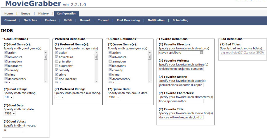

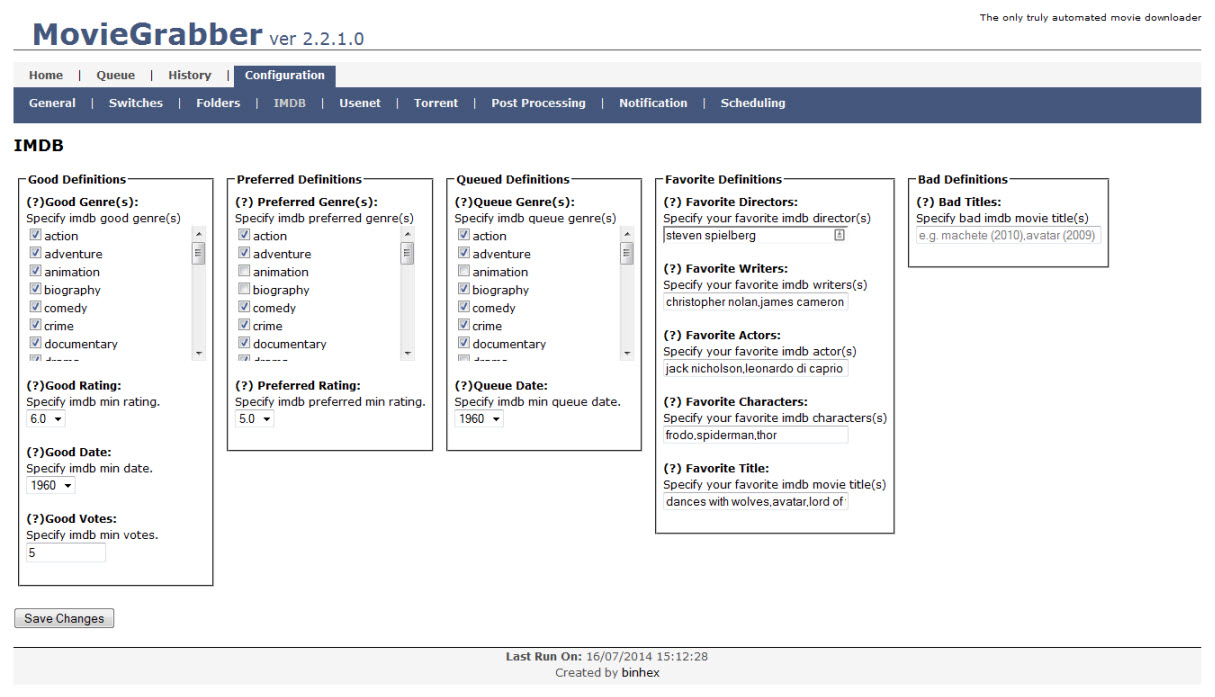

Here is my IMDB page.  I added some information in some of the fields, but still get no results.  (This info was added before the 1080p, bluray change I just made.

Still no luck, I amended the original search provider, and added a new, custom one with http://nzb.su/api, but still no results.
Ok can you pm me your config.INI file minus your apikey and I will load it and check it out.

binhex and I have exchanged a few PM's to try to resolve this, and I think he's gotten it fixed...
i think i have found the issue, well there are two issues in total, the first one you know about which is the url has changes for the api, the second issue is with the search criteria and how it deals with spaces between items, in short i wasnt stripping spaces from the comma seperated items in the "must exist" search criteria, so your search criteria of "1080p, bluray" actually gets translated into "1080p%20%20bluray" which matches nothing, i have now put in additional code checks for this so the issue should now be fixed.
so in short you can either get eroz to force a build for moviegrabber docker, then delete container and image and pull down again, or simply change your search criteria so it doesnt have a space in it, so just to be clear it should look like this (excluding quotes) "1080p,bluray" NOT this "1080p, bluray"
please double check you have the url still correctly set as https://api.nzb.su and port set to 443 then hit the run now, this works fine on my dev box :-).
thanks for your patience with this, i hope this sorts the issue for you, let me know either way.
I have removed the space and tested, and it is now pulling movies into the search history; yay!

i noticed from your config.ini your votes are very low, i would advise starting with a minimum vote count of around 10000 keep in mind imdb is massive and even a min vote count of 10000 will give you plenty of matching movies.
Done, thanks for the tip.
