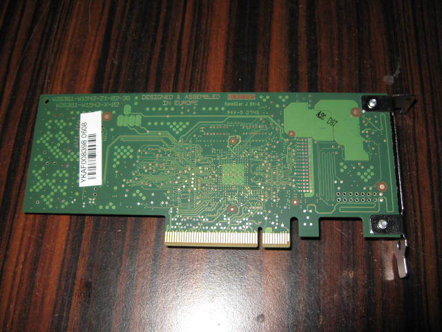

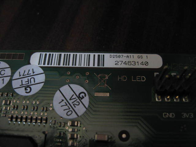

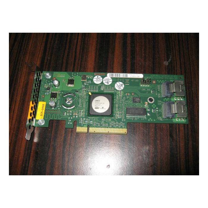

im in the hunt for a cheap unraid compatible card for more sata disks. found this old fujitsi LSI1068 MB D2507-A11 card locally online for 50 usd. it may be a lsi 1068e based card which is well supported in unraid as i cheked the forums here. but im not sure what card it is since its fujitsu rebranded and looks weird when i cross check the pictures with the other 1068e cards. can it be an old 1068 card and not good enough? i know the card wont work with more then 2tb disks but thats ok i have 8 2tb disks in my unraid build now.
i cant find much info for the card maybe smo here can help me
in the attachements the fujitsu cards picture and here the other 1068e chipset ibm and intel card example the card im about to buy looks very different : (

Your last link says it is a 1068 based LSI controller.  I believe I have seen posts here on these forums that indicate a 1068 based controller will only support drives up to 2TB.  So if you are looking to use larger drives I would find a newer controller.

from pictures looks like a lsi SAS 8208ELP version without heatsink to me i can just add a heatsink if thats all  :P

You will most likely have to crossflash the card but I can't tell you if it will work.
I know that the D2607 from FSC is not fully functional after a crossflash.

yes i checked the alternatives found some candidates on ebay and im in contact with them about shipping. found dell perc h200 and h310 near 100 usd. and yes the fujitsu cards looks like cripled all over dunno why look at the card i found no other similar chipsetted card from other brands has less components. the cards entire backside is empty, no ram not even a heatsink lol oh well.. saw the newer fujitsu cards crossflash problem also 1 SSF-8087 is disabled ouch!
