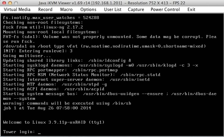

July 21, 201412 yr Can someone offer some advise please. I have run disk utility repair permissions with my mac on my SD card in my Kingston Mobilite G2 and Im still getting this error on a restart. The only plugins Im using are Dynamix. APC UPS and Dynamix System Monitor and I always shutdown with the WebGUI.

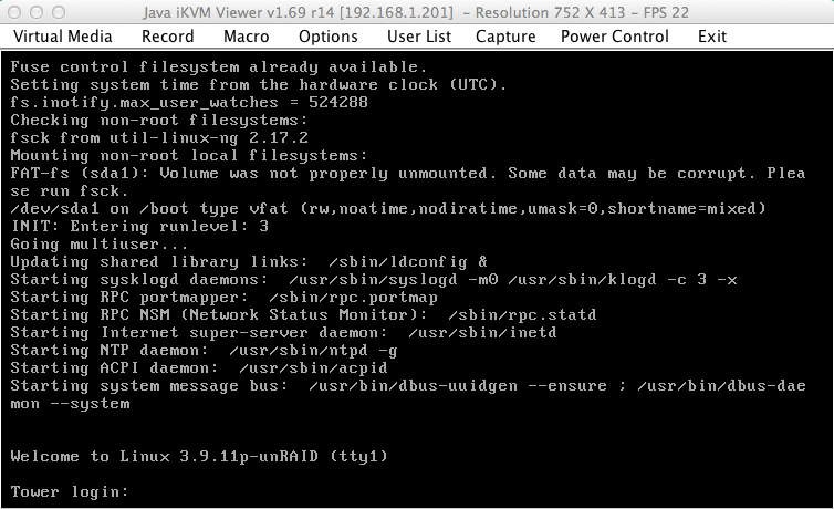

August 26, 201412 yr Author Sorry I have tried it and its not working for me RobJ. Here is a Screenshot after check the go file again and the script name. I have also included my syslog. syslog.txt
August 26, 201412 yr Author Do you mean after I have installed RobJ's mod I have to remove it and run it to remove the error?
August 26, 201412 yr Sorry I have tried it and its not working for me RobJ. Here is a Screenshot after check the go file again and the script name. I have also included my syslog. Sorry, my instructions were not sufficient. I've added a note about running Check Disk on the flash drive, and the need for a second boot to make sure it has used the revised Powerdown. Revised mod post is here, and my response to your post is here.
