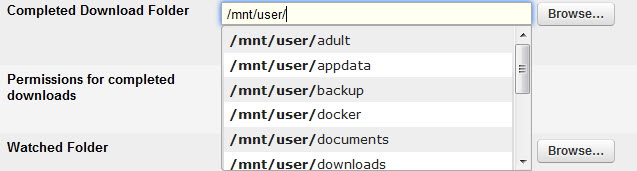

Once you type (or paste) that into the box in SAB, including the / then the box will show a dropdown that lists all subfolders under that location, which will be all your user shares.  Just navigate from there to whatever folder you want, and you should be good.

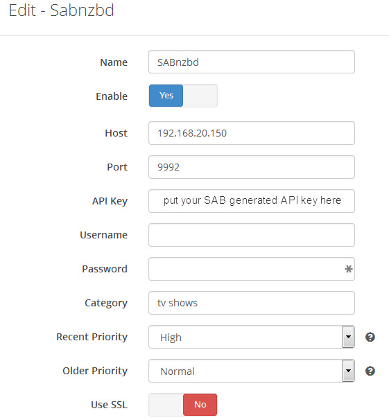

** I added a screenshot for you.
So Sab completed folder should point to my data array instead of completed download folder?  How does it take care of the post processing then?

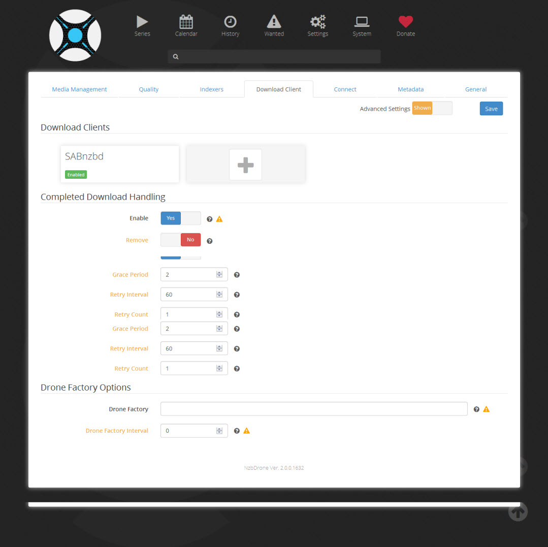

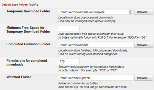

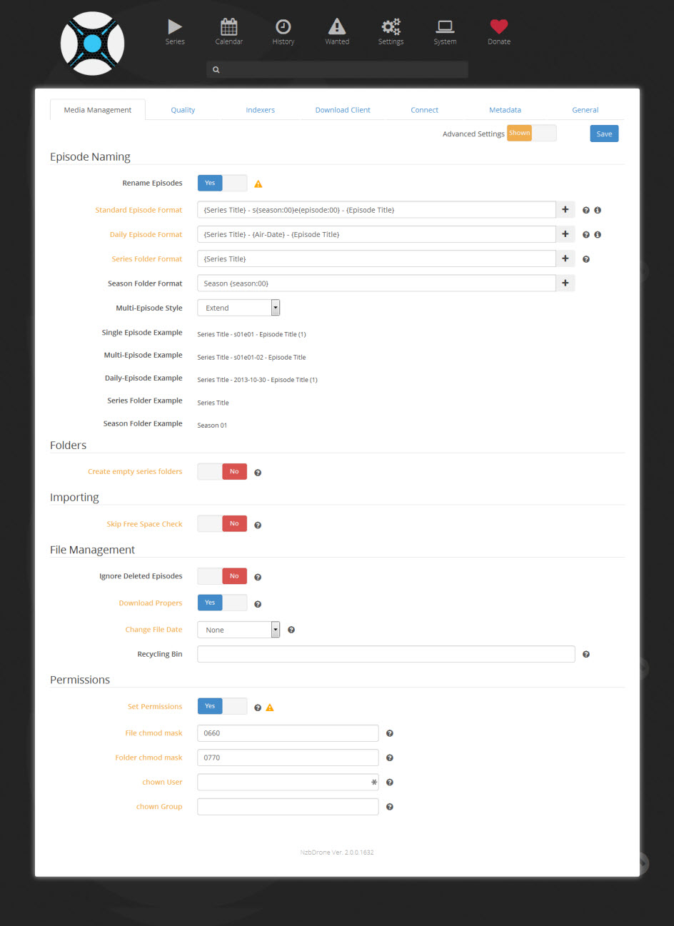

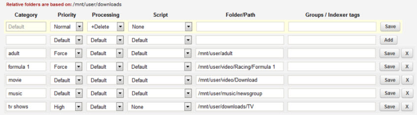

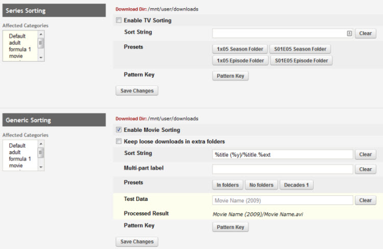

see screenshots for my settings.  you will probably need to modify to your specific situation, but this should be enough to get you resolved.
They are kinda big, so I'll post in several posts.
showing the settings for the SAB stuff
the pertinent setting for SAB.  Again, you'll need to change to your exact setup, but this should show how it all works on my system.

I see you have a category of formula 1.  How does Sab know you are d/l formula 1?
I change it manually in SAB.

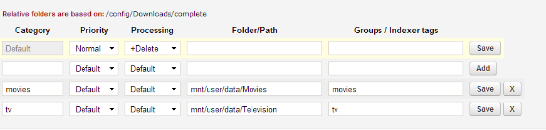

Folders
Categories

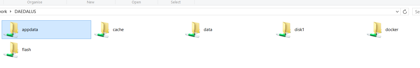

Shares

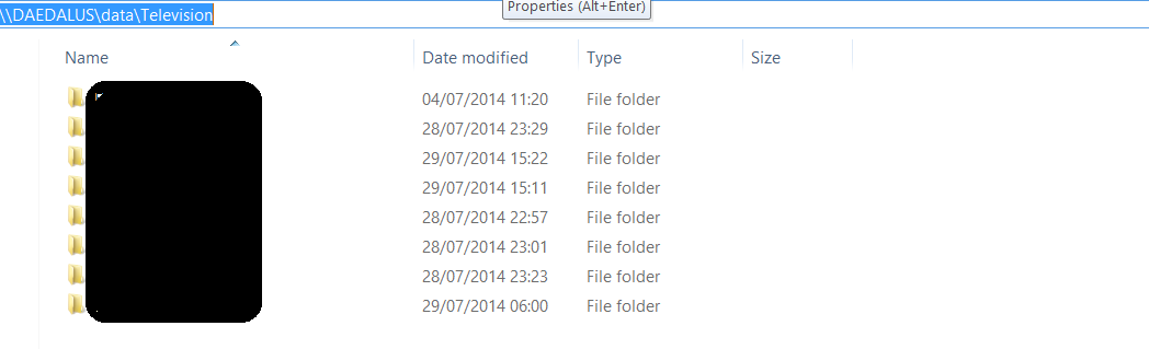

first, try /mnt/user/data/Television (notice the / before mnt)
Then, if that doesn't work, share your folders again, as that was your categories also.
Next, I'm not sure if tv and movies needs to be under groups on the right.
Finally, if still not working, show me your shares, but deeper, show a screenshot of /user/data/Television, so I can see the whole path.
Removed.
Attached
nothing attached, I still can't see your folder structure.
Open SABnzbd, go to config, folders.  There, in teh box to the right of Temporary Download Folder type /mnt/user/
do you see a dropdown box that shows your user shares?
if not, the docker is not setup correctly.

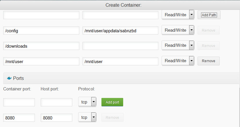

use the plugin to remove all SAB containers and images.  You want to start from scratch.
Then click the green plus, select the SAB template, and add /mnt/user to both boxes, then add (see screenshot).  then install.
