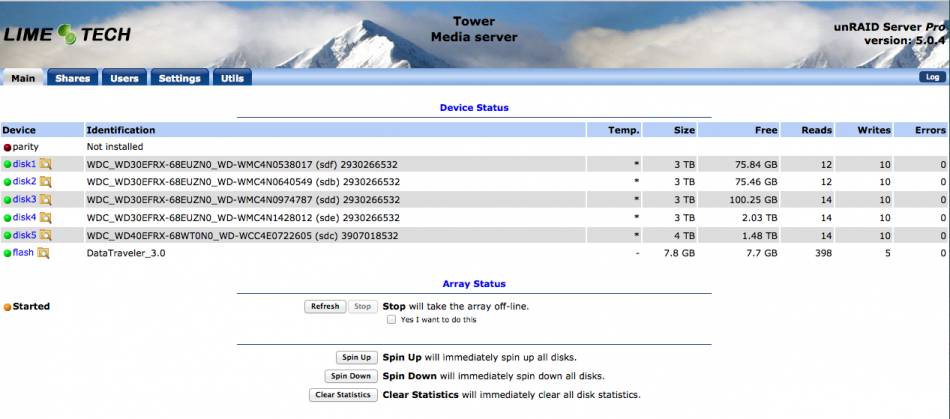

I am having problems with my server! I can view it online and I can see Tower appear on my network but when I click on it, I cannot access it. It comes up with connection failed! I cannot access it on my windows based PC either.
Screen shots & log included.
Any help is very welcome please.
Thanks

Your description of your problem is unclear. Since you have posted a screenshot of the webGUI I assume the connection problem you are having is not with the webGUI. Where are you seeing this problem, Windows Explorer? Maybe post a screenshot that shows the problem.

My problem is the following: I can access the server on the webGUI, however I cannot access it using my imac or my PC. If I click on Tower on my imac, it keeps coming up connection failed even though the server in online.
I will run checkdisk now. I don't know how to use it but a quick Google and I will follow the instructions.
Let's hope this fixes my issue. Report back as soon as I can.

I carried out checkdisk and fixed the problem.
