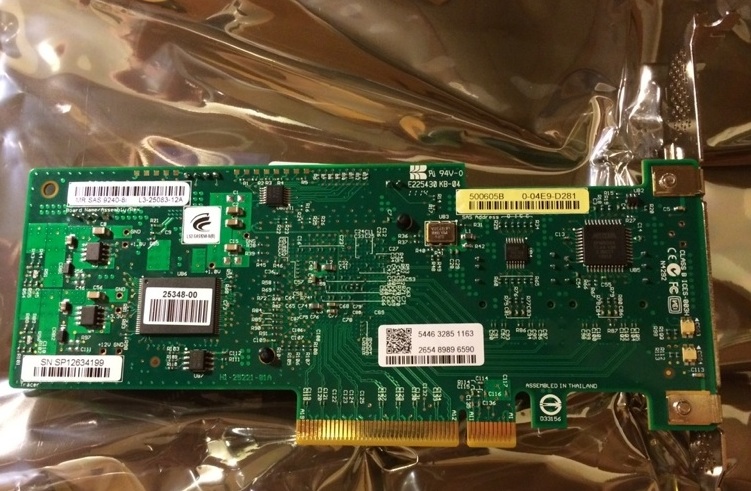

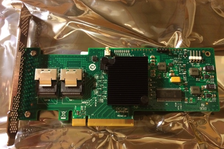

August 5, 201412 yr Hello, I brought it from ebay last week and just get it today. The price is around US$100. I haven't tried it yet as I wonder it is not a real card. It seems that the LSI logo is missing. Is it a fake card? Thanks a lot.
August 5, 201412 yr What does the sticker in the top left of the rear view picture say? It is probably an IBM ServeRAID M1015, which is a re-branded LSI 9240-8i.
August 5, 201412 yr Author What does the sticker in the top left of the rear view picture say? It is probably an IBM ServeRAID M1015, which is a re-branded LSI 9240-8i. Thanks for the reply. It says "MR SAS 9240-8i L3-25083-12A". Can the card be no LSI logo in the front and no LSI copyright statement at the back? Sorry that I am not familiar with the LSI card / re-branded card.

August 7, 201411 yr Hmm...I went up my attic and fetched my two spares. These are "real" IBM M1015s, pulled from System-X boxes. You are right, they do have a logo in the front side, left under the heat-sink, above the PCIe connector ...and a copyright on the back. Also on the back, the top left sticker states "SAS9220-8i .....". So, I stand corrected....sorry for the confusion The M1015/9220-8i resembles the layout of the 9240-8i or the 9210.8i resectively. I flashed two of mine with the 9240-8i firmware from LSI with no problems when P12 was actual. (the version was upgraded but the features stayed at M1015 level - the 9240 has got raid-5 support, whilst the basic M1015 has not). What everybody does is flashing the 9211-8i FW onto it, ignoring the fact that the layout of the 9211 is totally different to the 9210/9240....and it works. If LSI states that these were made for lenovo, then these are of a newer batch maybe. Could be, that there are some changes in FW that prevent cross flashing. But if the were made *by* LSI they probably should carry a logo...if made *by* lenovo, they should probably at least carry a copyright of the layout....
