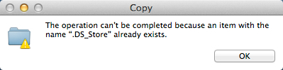

I am just started using unRAID with Mac.
I was able to make user Shares and copy files and folders to the server.
Although it is slower (10 MB/s) but I was able to copy files with no problem.
However, when I try to copy files back to Mac. I always get an error message
saying that .DS_Store already exists.  This happens for over both SMB and AFP.
Is this a known bug?  Then how can I get around this problem?

Then I copied one folder into the unRAID server and then copied the copied-folder back to mac on different hard disk.
At the end, I got the same .DS_Store error dialog.
I don't understand why I am getting the same error message here.
