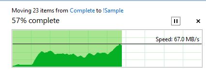

I was coping some large files from my cache disk to an array disk. It was going exceedingly slow - maybe 5-10 MB/sec. There was no other I/O on the array at that time. The only disks spinning were the cache, the target array disk (a fast disk), and the parity (also fast). I could not understand why it was so slow. On a whim I paused the copy and spun up all of the array disks. Immediately after resuming the copy, it started running hugely faster (see the screenshot below).
I am not running turbo mode (at least not on purpose).
Any idea why spinning up the array would speed up the copy so dramatically.
One more point, when monitoring the slow activity, it seemed that the reads from the cache were slow, but the writes were fast. I'd see the reading going along at 12 MB/sec and then get a bursted write at 60 MB/sec before the reads started again.
Note my copies are disk to disk, not using user shares.

Noticed something very strange.
it appears you are copying this through a windows machine... 7 or 8? I have seen similar occurrences when doing that. In my testing I browse to whatever share i want a file from and then realize, oops, need to plug in gig-e to get a good speed, plug it in wait for the network to come online via plugged in ethernet and start the copy. 9/10 times its at wifi speed (3-10mb/s) even though im plugged in. Seems Win 7/8 holds on to the share via the connection it was originally browsed with.
If i plug in right away and then browse to the share it goes as fast as the hardware allows it, generally over 100MB/s.

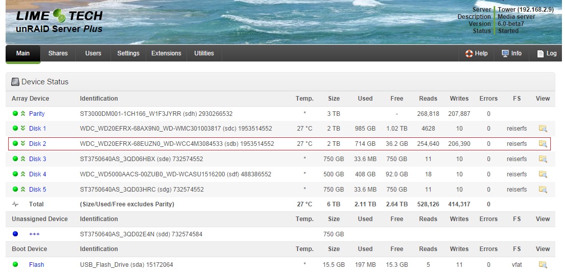

I may have found a bug today, or perhaps I'm doing something wrong but I've done this before in 5.x and it worked fine.
I upgraded a 750gb disk to a 2tb disk last night.  I precleared the disk beforehand.  Added it to the array and it began to rebuild.  All the data from the old disk is there and accessible but the disk did not expand to reflect the bigger size.  It knows it's a 2tb disk but it's still limited to 750gb.  Curious if it was just an error in the gui, I tried copying enough data to take it over 750gb via the disk share and it says there is not enough space.  It seems that the auto expansion did not take place. I've attached a screen shot.
Am I doing something wrong?  Is there a way to expand the disk manually now?  If it's a bug, do you need any other info from my system?
The auto-expansion was (temporarily) disabled when the new file system support was added.    Tom noted that this will be re-instated with v6.0 final (not sure if he plans to do it before then or not).
... I believe if you revert to Beta 6 and boot it will do the auto-expansion, but I'm not certain.  You may have to remove/replace the new disk and let it rebuild again.
