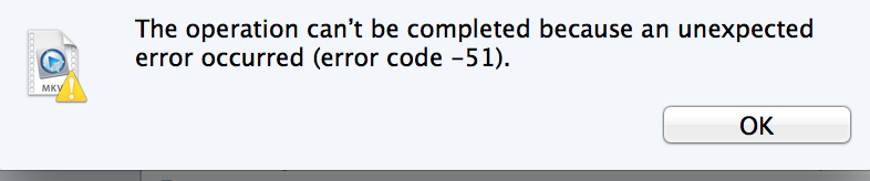

Here is the attachment and screenshot on a Mac.
syslog.tar.gz

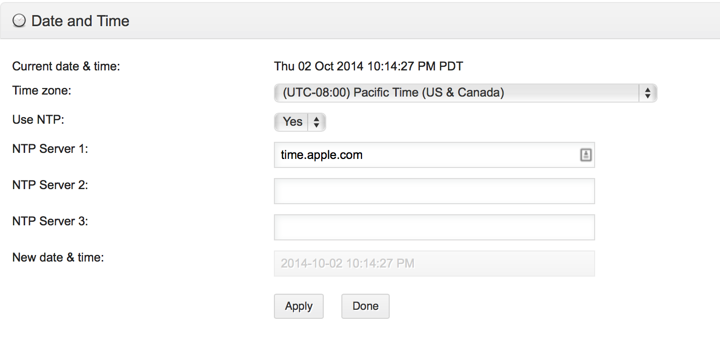

Sep 29 20:00:22 unraid kernel: rtc_cmos 00:02: setting system clock to 2014-09-30 02:59:59 UTC (1412045999)
So I suspect your timezone setting (or time offset) may not be set correctly.  Perhaps a sign reversal?  There's often confusion over whether the offset is a plus from UTC or a minus.  Try checking your time settings, reversing the sign perhaps.
Hello,
The disconnect happens from any OS accessing the server via CIFS. I've tried to turn the SAMBA logging on - nothing meaningful so far, it just says - Client close connection.
As far as the time setting I believe they are correct, internally unRAID is probably using UTC (see attached)
Thanks for your time.
