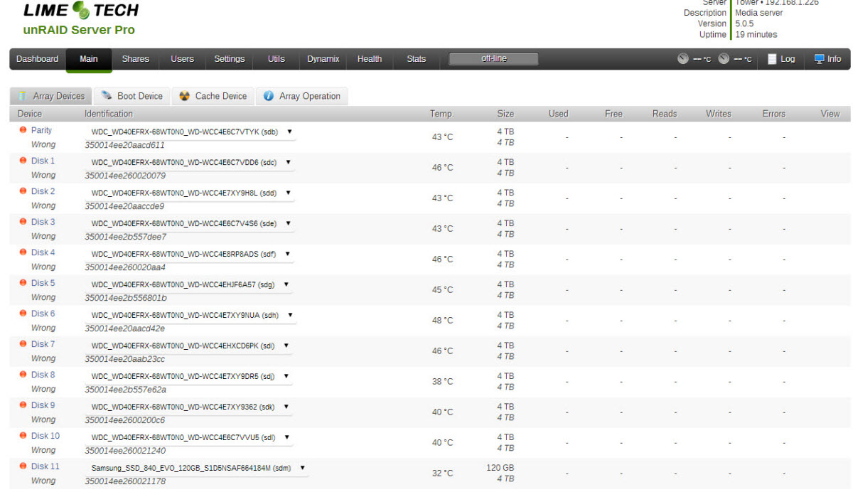

So I finally got around to updating the fw on the adaptec card and now all the disk are showing up and I can assign them. BUT there is a new problem... My previous fw did not list the model/serial number on the disks correctly they only had a number like this: 350014ee20aacd511 this was my parity disk btw. Now with the new fw the disk show up with model and a serial number like this: WDC_WD40EFRX-68WT0N0-WD-WCC4E6C7VTYK
Now the problem is that non of the serial numbers match the previous setup so therefor all the disk come up as wrong when I try to assign them. This of course happens when I go back to 5.0.5 because of the new fw.. I have attached a picture so you can see. From the picture you can see the new and old serial numbers . Is there any way to fix this besides just make a hole new array and use my backups? Thank GOD I have the backup.. :) Or just go back to the previous fw and stay on 5.0.5 forever..?
I would suggest the following:
  • Make sure you know which is the serial number for parity disk
  • Do a 'new config' via the options on the Utility tab
  • Assign all the drives EXCEPT the parity drive
  • Start the array and check all the drives look OK.  If any drive shows as 'unformatted' that almost certainly means that you made a mistake and that is your parity drive.
  • If it all looks OK, you can then stop the array; assign the parity disk; and let new parity be calculated
Ok, I'll try that. I've never used the new config option so not entirely sure what it does, but I'll read up on that before I do it. Either way this issue seems to be resolved now that i can assign all my disks, and I'll get the array up an running soon when I've sorted out this new issue. So I'll just rename this thread to solved, boot up beta8 and check if everything else works. Thank you all for your help! :)

No.  unRAID thinks all the disk serial numbers are wrong which is why you have to go via the new config route.
In theory when going that route you could also initially assign the parity and tick the box to say it is already valid.  This would save rebuilding parity.  However if you accidentally assigned one of the data disks as parity then on starting the array unRAID would immediately try and start building parity on it and destroy the existing data (from previous forum messages this has happened a number of times).    This is why I recommended starting without parity assigned - it gives you a chance to notice the incorrect assignment and rectify it before any damage is done.  I think the chance of a failure while rebuilding parity after checking the assignment is correct is lower than the chance of a human error while assigning the disks.
Yeah, like itimpi said it didn't work, but the new config worked like a charm and the array is now up an running with a Parity-Sync in progress! :)
