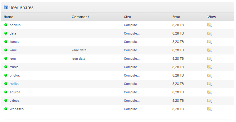

The first attachment, sharesgood.png, shows my current shares.  All if good.
