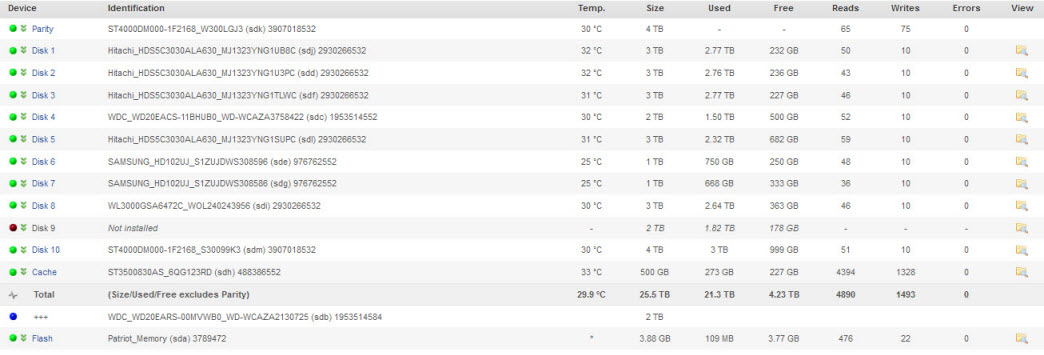

So, I finally settled into a new place, and hooked up my server.  I noticed some sketchy performance when watching video, and some investigation led me to discover that I had a drive red-balled.  The array had started fine, but on drive seems to be bad.
I took off the cover, and reset all the cables, and when I restarted, the array wouldn't even start, it couldn't even find the drive.  I then re-reset all the cables, and then refreshed the array display, and the array started, but the drive is still red-balled.
I have a 3TB drive on order, and the red-balled drive is a 2TB drive.  So, I don't want to upgrade to beta7 just yet, and I'm not sure if there are any other troubleshooting steps I should take before just replacing the drive.
The drive on order is actually meant to replace a 1TB drive that is showing some errors, not the one that has red-balled, so I suspect I need to order yet another drive, but I don't want to do too much changing until I get some guidance/suggestions on how I should proceed to at least get back to having a protected drive.
Thoughts, ideas, suggestions?
thanks!

Device 	Identification 	Temp. 	Size 	Used 	Free 	Reads 	Writes 	Errors 	View
[spin Up] Parity	ST4000DM000-1F2168_W300LGJ3 (sdi) 3907018532	*	4 TB	-	-	6253	6361	0
[spin Up] Disk 1	Hitachi_HDS5C3030ALA630_MJ1323YNG1UB8C (sdj) 2930266532	*	3 TB	2.77 TB	232 GB	966	33	0	[browse /mnt/disk1]
[spin Up] Disk 2	Hitachi_HDS5C3030ALA630_MJ1323YNG1U3PC (sdd) 2930266532	*	3 TB	2.76 TB	236 GB	573	20	0	[browse /mnt/disk2]
[spin Up] Disk 3	Hitachi_HDS5C3030ALA630_MJ1323YNG1TLWC (sdf) 2930266532	*	3 TB	2.77 TB	227 GB	1401	12	0	[browse /mnt/disk3]
[spin Down] Disk 4	WDC_WD20EACS-11BHUB0_WD-WCAZA3758422 (sdk) 1953514552	30 °C	2 TB	1.50 TB	500 GB	777	105	0	[browse /mnt/disk4]
[spin Down] Disk 5	Hitachi_HDS5C3030ALA630_MJ1323YNG1SUPC (sdg) 2930266532	33 °C	3 TB	2.32 TB	682 GB	6689	6054	0	[browse /mnt/disk5]
[spin Down] Disk 6	SAMSUNG_HD102UJ_S1ZUJDWS308596 (sdc) 976762552	27 °C	1 TB	750 GB	250 GB	904	16	0	[browse /mnt/disk6]
[spin Up] Disk 7	SAMSUNG_HD102UJ_S1ZUJDWS308586 (sdb) 976762552	*	1 TB	668 GB	333 GB	443	16	0	[browse /mnt/disk7]
[spin Up] Disk 8	WL3000GSA6472C_WOL240243956 (sdl) 2930266532	*	3 TB	2.64 TB	363 GB	798	16	0	[browse /mnt/disk8]
[spin Down] Disk 9	WDC_WD20EARS-00MVWB0_WD-WCAZA2130725 (sdm) 1953514552	*	2 TB	1.82 TB	178 GB	1226	16	0	[browse /mnt/disk9]
[spin Down] Disk 10	ST4000DM000-1F2168_S30099K3 (sde) 3907018532	27 °C	4 TB	3 TB	999 GB	1827	97	0	[browse /mnt/disk10]
[spin Down] Cache	ST3500830AS_6QG123RD (sdh) 488386552	34 °C	500 GB	272 GB	228 GB	5047	24,476	0	[browse /mnt/cache]

If all connections look good, if you have a usb->sata dock you could try connecting the drive to make sure it is working.  Or if you get a new drive, connect it on that same connection and see if the new drive is recognized.  If so it is probably a failed drive..
So, I've removed all drives (and re-labeled them all, so I can see what is what more easily), then moved a few around, to organize a bit better, then reinstalled all the drives.  The result is that the red-balled drive is in a new location, and is connected to a different SATA drive.
When I booted unRAID, it booted really quickly, and the array started.  I figured that was a good thing, but then I took a look, and is shows Disk 9 as not installed, but now it also shows the WD drive as just a normal, available drive in the list.
I want to think this is a good thing, and that I can just stop the array, assign it to disk9, then restart, but before I do, I figure I should check and see it that's actually a dumb idea.
Screenshot attached...
thoughts?
This sounds similar to the scenario where people intentionally make unRAID forget about the drive so they can rebuild it onto itself. I think if you assign it unRAID may want to rebuild it. Whether that is what you should do is unclear. Have you got another drive you could rebuild onto?
Can you run the smartctl command against /dev/sdb ( the disk outsite the array )
My guess is that it came up once without the disk installed, so it is set to missing, and now showing up as a disk separate from the array.
You could try mounting the /dev/sdb1 partion and verify it is the data that should be on that disk if the smart test passes and looks like the drive is still in good health.  The safest would be to rebuild slot 9  on another drive, then you still have the original data on that disk if for some reason the rebuild fails.
The last option, if you are sure all the data is correct on the drives, you can start with a new config and rebuild parity off all the data drives.  Sounds hairy, but I have done that a few times and got my array back.  You have to remember with unRaid all array disks are just individual stand alone data drives that are part of the array, and the parity disk is only really used for emulating a failed disk and rebuilding.

The SATA error flags you are seeing (RecovComm and PHYRdyChg) are typical of a bad connection, perhaps loose and vibrating, or poor backplane connection, or perhaps poor or noisy power.  You have 2 separate drives with the same issues, connected to channels ata12 and ata14.  I understand you've reconnected drives to different ports, so that in itself may have improved all connections.  In cases like these, the drives themselves are usually completely fine.
The drive looks fine on the SMART report.  I suspect you could simply assign it to Disk9 and it would just rebuild onto itself just fine ... HOWEVER -- it's safer to do that with a different disk.    That way, if anything should go awry with the rebuild, you'll still have the original disk to copy your data off of.
