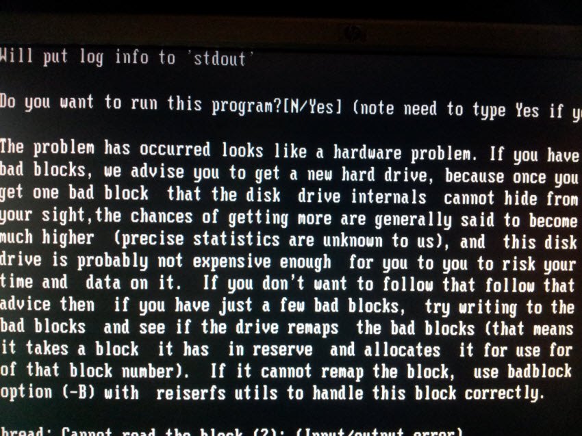

duly noted. i don't know what i was thinking. i will not run reiserfsck command like that again.  Ran reiserfsck the correct way and all disks were free of corruption except disk 7 and disk9. no suprises there. The text went a little like this....picture of actual message attached along with smart reports.
The problem has occured looks like a hardware problem. if you have bad blocks, we advise you to get a new hard drive...etc
