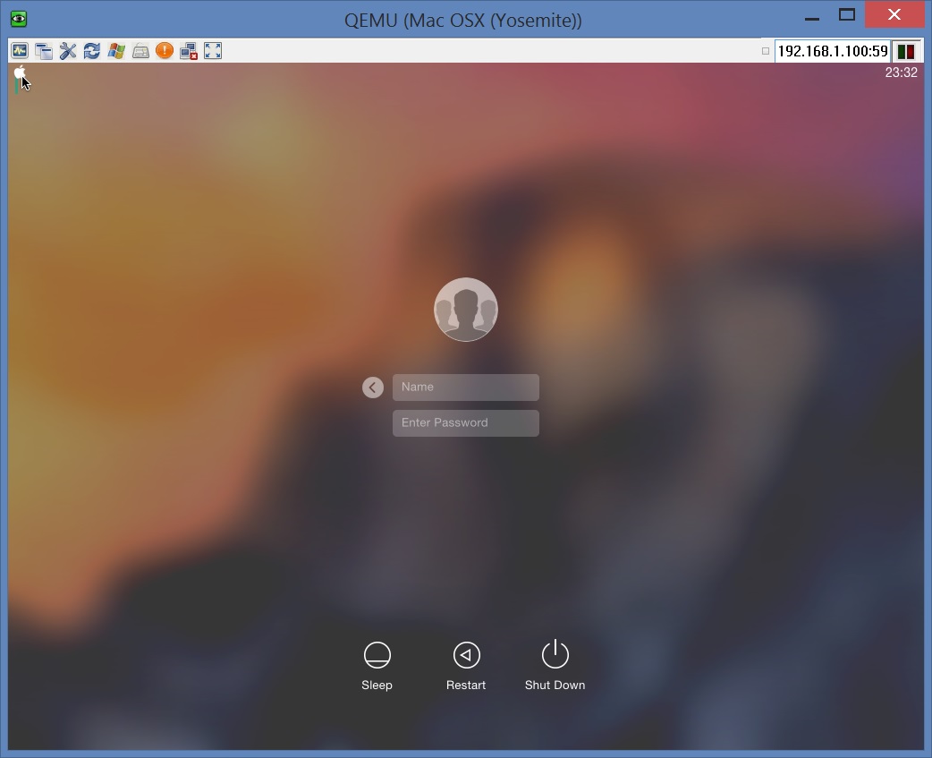

If you look at the attached screenshot then you will see that the OSX mouse pointer is at the top-left of the VNC window.  It stays there and I cannot get it to follow the 'local' mouse pointer in VNC as I can with Windows and Linux VMs.
The Virtual disk for the  VM in question was originally created in VirtualBox on my main PC running Windows 8.1, and there the mouse pointer at the OSX level DOES follow the mouse pointer on the PC.  I also get the same results if I start with an empty virtual disk and run the OSX installer - but there the problem happens when the installer switches to graphical mode so I cannot get to the menu to run Disk Utility to initialise the virtual disk.
So if you follow my guide you get to Step 04, #6 and then at that point once the OS X VM switches to graphical mode you cannot move the mouse at all in your VNC session correct? What happens if you try and use unRAID's built in VNC window? What I may need you to do is at Step 04, #5 boot with the "-v" flag and record what the output is. Did you follow all the Steps 01 thru 04?
Yes - it as step 4.6 that I cannot get the mouse to operate.
I do not use the built in VNC remote as for some reason I get no output until I get the 4.6 or later.  In other words it does not seem to be working to give me the boot screen.  If use a VNC client that is not browser based the I do get the CD boot screen
I have tried running with -v but spotted no useful output.  At the point things go wrong since the system has switched to graphical mode there is no longer any visibility of the -v output.    I do not know if there is a way to capture that output?
