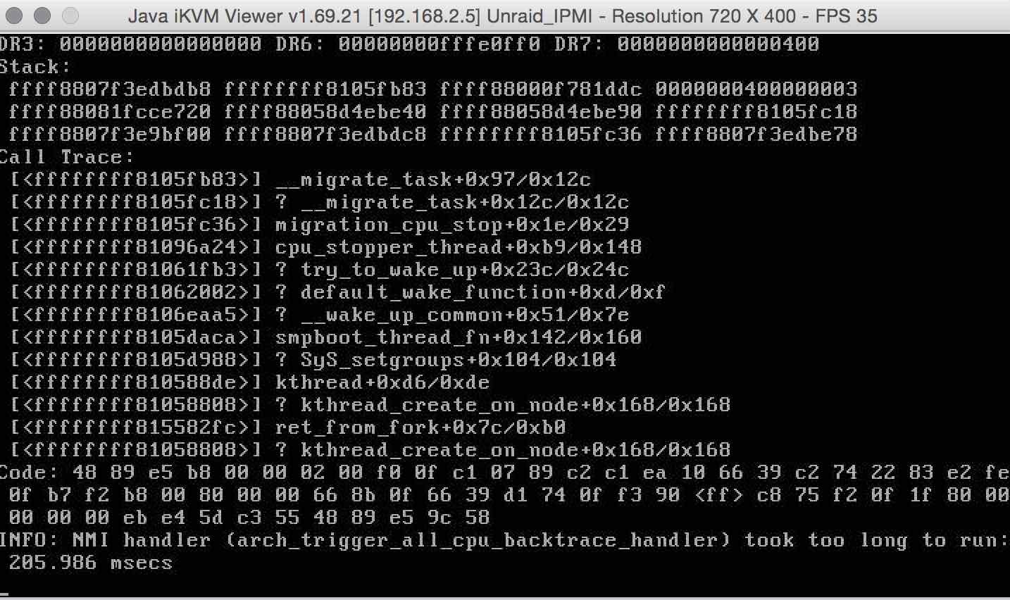

Since Beta 7 release, I updated my Flash drive and change my default boot to the default (was previously booting to Xen Kernel) then boot to Beta7.  I did start migrating my array to XFS filesystem.
My issue is that since 3-4 days, my server crash randomly at least twice a day.  I don't know if it's because I'm copy massive data at the same time.  I alway Rsync in 3 different Screen at the same time and I move 3 x 1.5TB to new drives freshly format to XFS.
Attach is a screenshot from my IPMI console redirection to see the error.  It's always the same crash... only happening since Beta7.  I NEVER had a server crash before since I built it in april.  I always ran on Beta 6, never on a 5.x Unraid.
Any help, ideas etc. ??

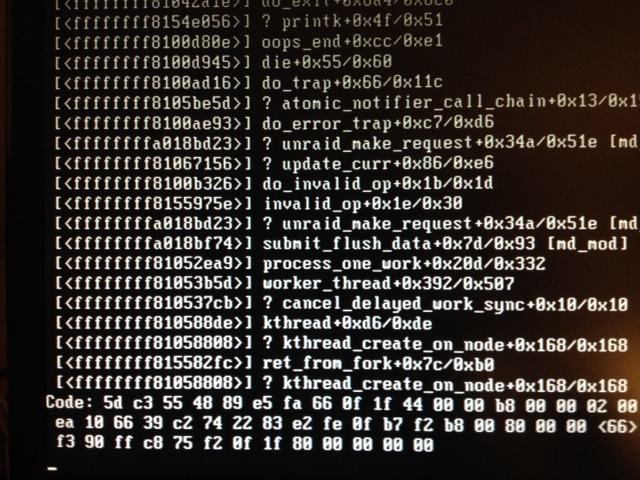

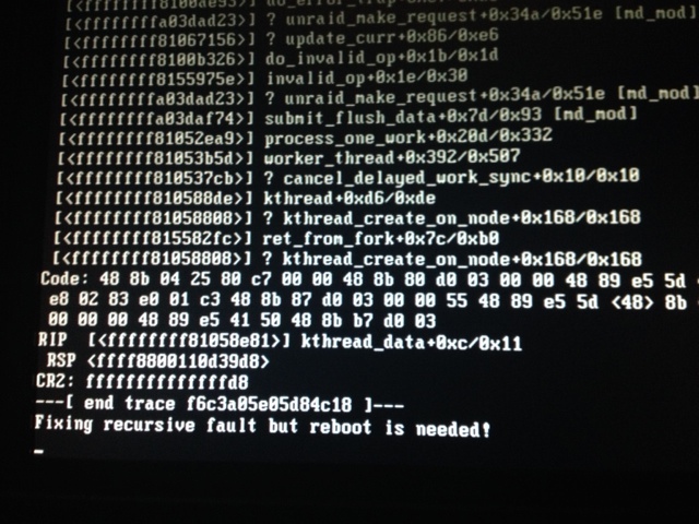

I've had two hard crashes while on 6b7 while rsyncing 1.2 tb of data from a reiserfs array volume to a xfs array volume.  Both happened after about 120 gb of data transfer;  I have 4 GB of RAM. I got a screen shot of the first time, but not of the second.  (see attached).
Funny thing is that both times a power button reboot failed to mount drives.  I had to login and use powerdown -r to restart apparently normally.
I scrolled through my logs but don't see a copy of the log from either time in /boot/logs
I've restarted the rsync and will see if it happens again.

My first impression was that the two faults are different - the backtrace is significantly different, but I guess that one possible reason for NMI code to run for more than three minutes is that it gets into a recursive loop.
Having said that, it would be wothwhile for both of you to perform an extended memtest.
This is the screenshot of my third crash, again after about 120 gb of data transfer on 6b7 from a reiserfs to xfs volume (/mnt/disk# > /mnt/disk#)
Problem:  Crash on rsync copy between share drives.
Expected:  Copy 1.2 TB successfully
Result: abrupt system shutdown after about 120 gb (about 3-4 hours); console freeze and no array or ssh.
System: ASRock MB running 8 drives on 6b7; plain unRAID + docker (media apps); APCUPSD and cache_dirs running (both latest updates) + screens for the console. Parity check not running. Array mounted with minimal use.
Edit:  I did a memtest and there were no errors detected in two cycles.  I have 4  GB./Edit
Note: I previously said that a powerbutton reboot wouldn't mount arrays;  it seems that it will but it is slower than usual (maybe fsck?).
I'm a couple of hours from the next crash and will post that screen too.  There seem to be similarities in my two crashes but differences from Pducharme's.
Dennis

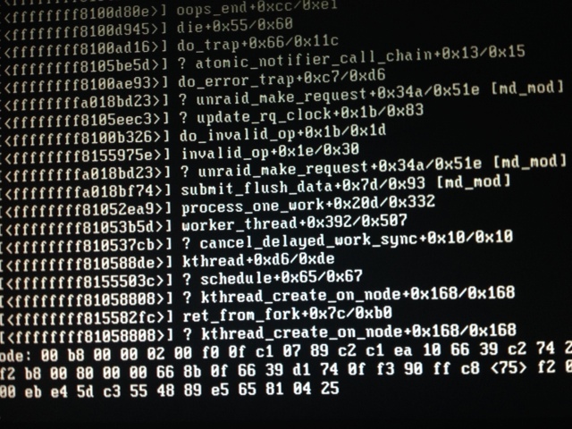

Over the weekend I had three more hard crashes while copying from a reiserf formatted array drive to a xfs formatted new drive via an rsync -avh /mnt/disk1/* /mnt/disk2/ command.  The screen shots of the console are below; there are a lot of similarities.
Things that don't work:
I tried booting unRAID into safe mode for the last two, but it still crashed.
Turning off (or on) Parity check simultaneously.
Things that might work:
escaping our of rsync and then restarting every hour or so.
Things that make it work later or sooner:
Copying mainly 1GB media files:  Takes 2-3 hours at about 120GB
Copying tiny Plex metadata files:  Took 20 minutes.
I did check my memory and 2x shows no errors.
Twice after a crash the array failed to mount and showed 'drive not found' (the reiser source volume)but it reappeared after a graceful reboot.
I'm going to try rsync between two reiser drives next.  (my migration to the new xfs drive is finally near done).
Edit:  Actually I'm going to try the same rsync copy on 6b8 /Edit
Thanks
Dennis
third crash

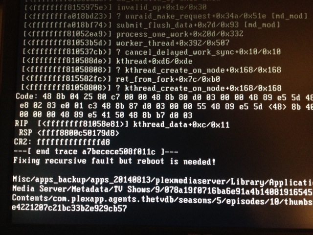

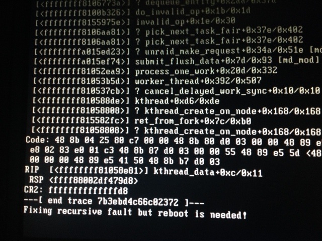

fourth crash  (actually, there have been about 8 in transferring 1.2TB but these are the ones I have console pics of. Done for now.
This is the one that crashed rapidly while copying myriad Plex thumbs.
D

I chased down my issue and related the story in another thread:
http://lime-technology.com/forum/index.php?topic=35043.0
in essence there is a bug in 6b7 and 6b8 that affects high disk use copies (maybe only to XFS volumes) in the unraid.c driver.
Sep  5 00:57:04 Tower kernel: kernel BUG at drivers/md/unraid.c:461!
Sep  5 00:57:04 Tower kernel: invalid opcode: 0000 [#1] SMP
Mine still reproducibly crashes when I rsync almost anything over 10-20 GB.  Tom says it's on his radar.
I only recently learned to ssh in from another computer and leave a tail -f /var/log/syslog process running to capture terminal events (ha ha I didn't mean that as a double entendre).
In about half the crashes I found the syslog capture highlighted the issue with the word "BUG"
Dennis
