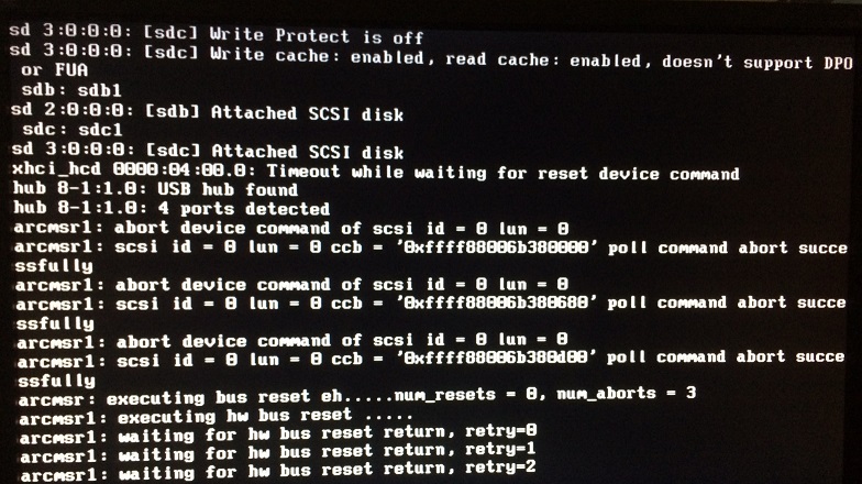

Description: I upgraded from the 5a Beta to 7 to find that my raid card (in JBOD) is no longer being detected by the OS. :(
Once failing and reaching the login prompt none of the drives connected to the card are appearing. I've attached some screenshots of the boot process.
I installed beta 6 to see if it was a new update but it appears to be an issue in beta 6 as well.
I have now rolled back to 5a and it appears to be working fine again.
Would love some direction on how I can rectify this or provide the devs some assistance in resolving it?
How to reproduce: Boot unraid with ARC-1230 installed...
Expected results: boots with all drives connected to the card detected
Actual results: No drives connect the the card are detected

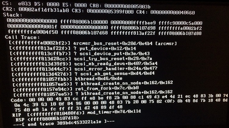

2nd Pic

Hi RobJ / Tom,
Just had a chance to sit down and look at this, thanks for pointing this out. I'm using an AMD board so I did the equivalent of turning off VT-d and disabled IOMMU instead and this has solved the problem and all drives are now showing!
Thank you!
