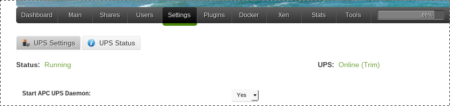

These statuses will show:
'ONLINE TRIM' will show 'UPS: Online(trim)
'ONLINE BOOST' will show 'UPS: Online(boost)
This way you can tell if the voltage is being trimmed or boosted and the online status will show properly.
UPS Status Page has been reformatted.
Okay, but it is still treated as an error condition (sort of) because, although the status is shown in green rather than red, the other items of information are omitted from the top line: see attachment.

A new version of apcupsd is available that fixes the status when the ups is in trim or boost.  Apcupsd will be included in the next beta release of V6.  I will implement these changes after the next beta is released.  This will take care of the problem for the short term until the next beta release.
Mine is in TRIM condition at the moment (256V on a nominal 230V line!) - I can confirm that the fix is working.  Many, many thanks.  I wait for a BOOST condition, but I'm sure it will be fine.

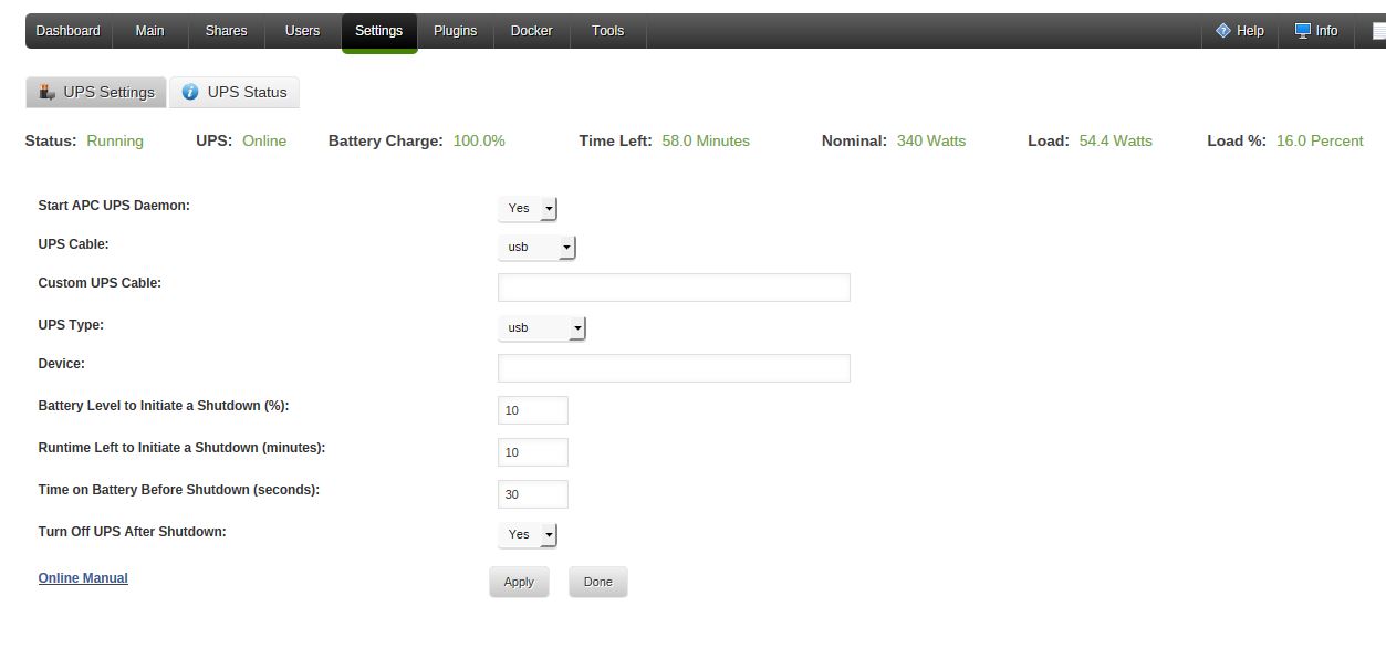

Did you try all of the various options under UPS Cable and UPS type?
No. After reading your post I tried all. I list where I get an output:

Only this last option is giving some output for the UPS variable instead of showing "lost communication". I don´t know what this means. Also, if I change any of the options under "UPS cable" I get the same output (with the exception of "custom").
Let me know what you think.
Rgds.
No idea.  I knew it was just worth a shot
The last choice you made is for a networked master slave arrangement.  Be sure you are using a good USB port.  Try another USB port.
Hi, I will try all my usb ports. Is there a way to test them? Any specific parameter to look for?
Also, what should the plugin report after status:runinng ...in Ups:___?
Rgds.

Like this (Appearance may be different):
Yes.
I don't know how you can test the USB ports except to just try them.
