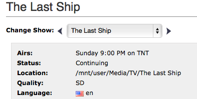

So it's when you initially add the show, and where it asks you to save, that will be the final destination.  Thanks for the clarification on this.
