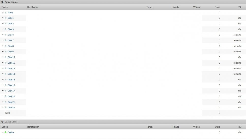

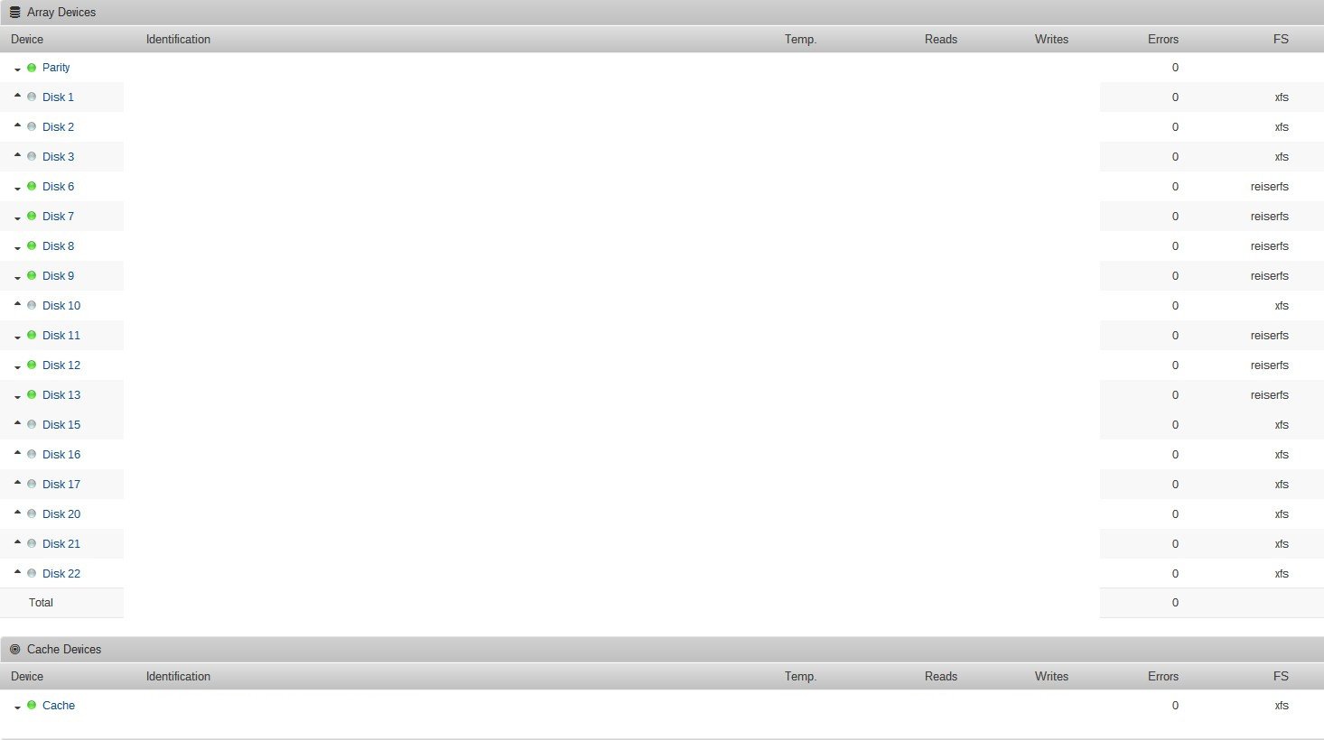

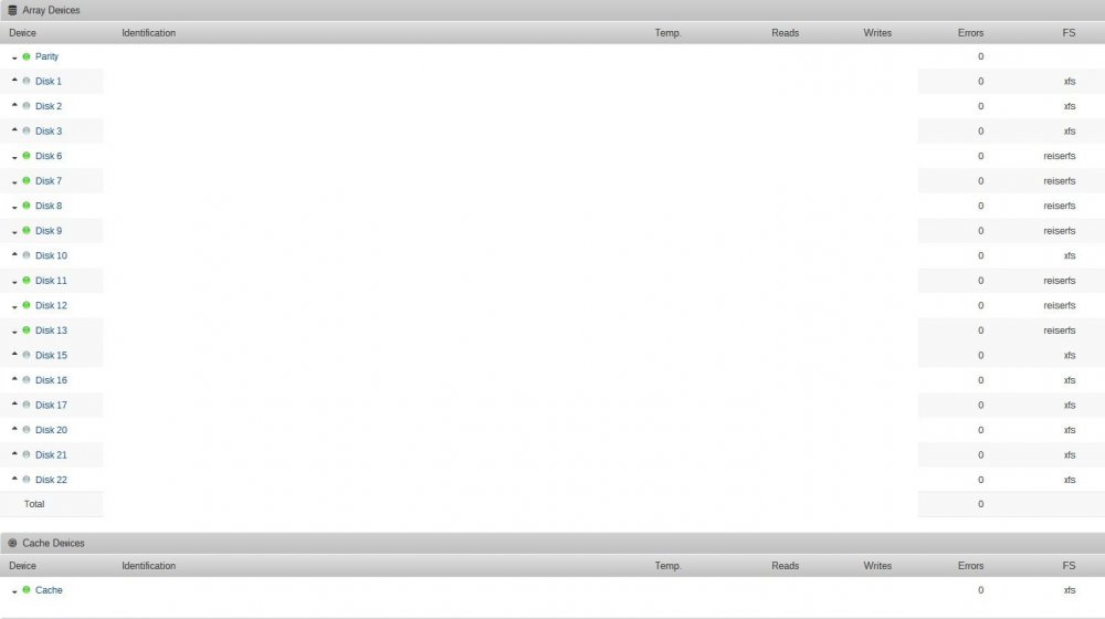

I now have a mixed array of reiser and xfs disks and I can confirm that when I stop a docker container, if the array disks are spun down ONLY the resier disks spin up.
Is this a known issue or a config specific problem?
Any thoughts on this. Best case scenario is that it is PEBCAK but it doesnt seem to be obvious if it is. The only thing I can think off I do differernt than "some" is I often use "/mnt/cache" rather than "/mnt/user/" although I dont see why this would cause spin up on.
As an illustration here is a before and after performing a single docker container stop. Notice the parity come up as well. Comparing write counts before and after (sorry I edited them out by mistake) I can see most of the RFS disks write count increase by 7 or 8. I am wondering if this is some sort of spin up caused by the docker container issuing a disk flush such as SYNC and RFS handing that differently than XFS.
