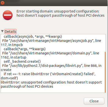

I'm getting a bit closer here to getting GPU passthrough working (win8.1), or at least, I think I am.  I have set up Virt-Manager on a separate Ubuntu VM to experiment.  After adding the PCI Host Device, I receive the following attached error message.
Error starting domain: unsupported configuration: host doesn't support passthrough of host PCI devices
Is there anything else on the host configuration that I need to configure?
I appreciate the help
What is your host hardware detail and please post what you have in your syslinux.cfg.
  append intel_iommu=on vfio_iommu_type1.allow_unsafe_interrupts=1 pcie_acs_override=downstream initrd=/bzroot
Host Hardware: Supermicro X9SCM-F, Xeon E31240

Updated my syslinux.cfg with your example.  Still getting the same error when attempting start of VM
dmesg | grep -iE "dmar|iommu"
Command line: intel_iommu=on vfio_iommu_type1.allow_unsafe_interrupts=1 pcie_acs_override=downstream initrd=/bzroot BOOT_IMAGE=/bzimage
Warning: PCIe ACS overrides enabled; This may allow non-IOMMU protected peer-to-peer DMA
Kernel command line: intel_iommu=on vfio_iommu_type1.allow_unsafe_interrupts=1 pcie_acs_override=downstream initrd=/bzroot BOOT_IMAGE=/bzimage

Have you checked your bios?  Is VTd enabled?
