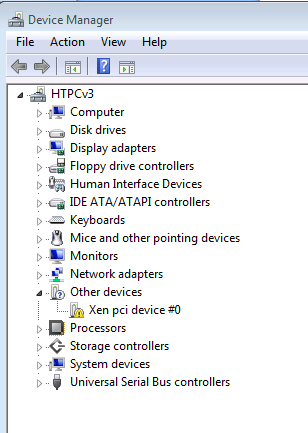

My device manager output in windows is attached.  I'm not 100% sure if that pci device 0 is normal or not.  Some googling gave me mixed results.

Do not pass through device 5, it is not necessary and not supported to pass through bridges.  Also remove that pciback hide from your syslinux.cfg.  not necessary in unraid.
