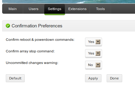

Have you tried loading the webpage on another computer to see if the checkboxes to enable the buttons are available on another machine?
those are all dockers I guess they are not excluded from starting up.
Another thought.
Are your confirmation settings default, or have you changed them?
Another thought.
oooh i might have changed them. Looks like they are all set to no
set it back to default, that fixed it! thanks!

Try toggling it back the way you had it, and see if the buttons show up active. I suspect there is something broken in the code.
