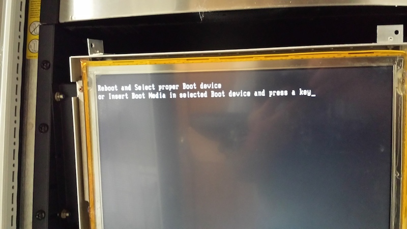

September 19, 201412 yr i picked up this board and am having difficulties getting it to boot from the USB drive. i go into the bios, and make the usb drive priority #1 (it sees the drive in there and labels it by name: USB_SanDisk) i have tried reformatting the flash drive, but with no luck. the post screen seems to see everything (the 6 hard drives from the motherboard (technically 5 since i have a bay open), 7 drives from one of the Sat2-mv8 cards (again one bay open), 8 drives from the other Sat2-mv8 card and the usb drive. when it gets to the part where it should start loading the bizimage and bizroot, it never gets there. it says "please reboot or insert the media with the correct software (or something along those lines). also, the USB drive seems to have gone dormant in the meantime. there is a slow fade on and off from the drive itself. I have tried all 4 usb slots on the motherboard (2 on the back and the 2 on the board itself). any help would be appreciated christopher

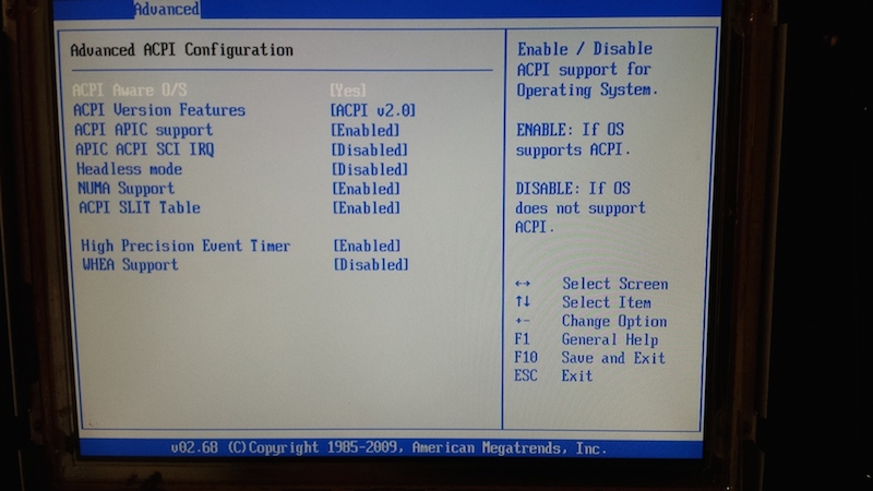

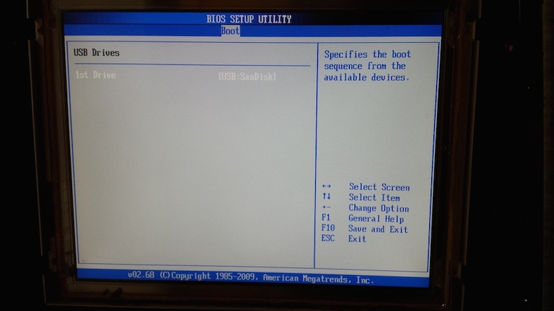

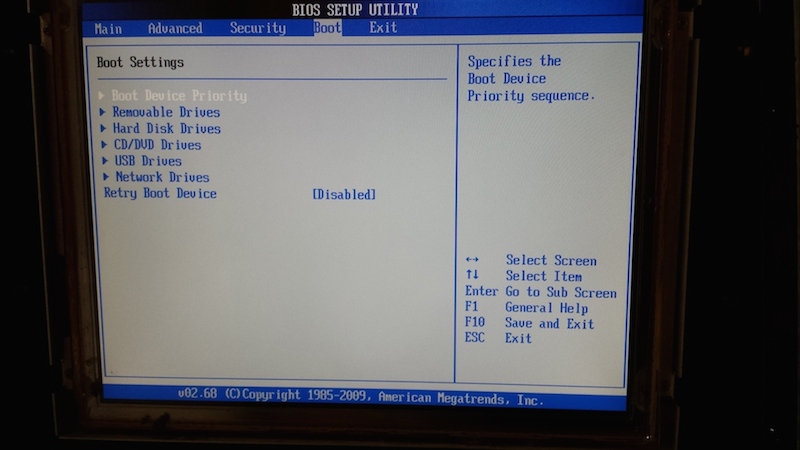

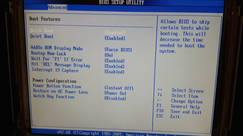

September 19, 201412 yr Can you take a pic or a few of your BIOS page and upload here for us to see? I want to see how it shows the flash device in the BIOS.

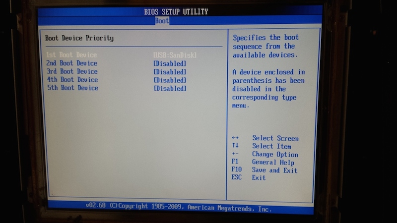

September 19, 201412 yr Author just arrived at work for the day. i will be back home in 10 hours or so and will upload some shots then. here is what i can tell you from memory under the "boot" section of the bios screen it goes like this boot device priority - 1st boot device - USB SanDisk USB Drives - 1st drive - USB SanDisk i will snap some shots when i get home though are there any screens in particular that you are looking for? christopher
September 19, 201412 yr just arrived at work for the day. i will be back home in 10 hours or so and will upload some shots then. here is what i can tell you from memory under the "boot" section of the bios screen it goes like this boot device priority - 1st boot device - USB SanDisk USB Drives - 1st drive - USB SanDisk i will snap some shots when i get home though are there any screens in particular that you are looking for? christopher Mainly your boot priority and what in particular I'm wondering is if your BIOS identifies the flash device twice (once "vanilla" and the other as a UEFI boot device). I haven't been able to get unRAID to boot off USB if I specify the entry with the UEFI option.

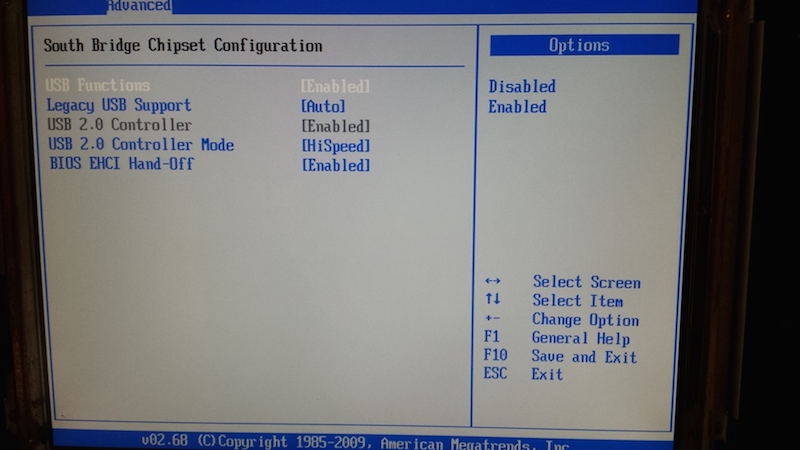

September 20, 201412 yr Author here is what i have so far https://www.dropbox.com/sh/u2z0y1kzjn6a921/AAC-BUrgLcdBHHXOyDLd3PUua?dl=0
September 20, 201412 yr OK this one is really stumping me... Now I know that this worked on your previous board, but can you plug the stick into your pc and run make_bootable.bat again and if on windows, make sure to run it as an administrator? Just want to sanity check this. Also, do other USB boot devices work?
September 20, 201412 yr Author Alright, we are up and running (doing a parity check now). here is what happened. before reading your response i tried a brand new san disk cruizer flash drive (loaded with the free unraid software). still nothing. then i downloaded ubuntu and loaded that onto another flash drive, still nothing. after that i removed both of the pci-x sat2-mv8 cards and put my original UnRaid usb back in.... it booted up. went into the bios and found these settings Slot1~Slot3 PCI-X Option ROM/Slot4~Slot6 PCI-E Option ROM Select Enabled to enable the onboard PCI Slot Option ROM as specified (except the VGA card). This is to boot computer using a network interface. The options are Enabled and Disabled. Load Onboard LAN1 Option ROM/Load Onboard LAN2 Option ROM Select Enabled to enable the onboard LAN1 or LAN2 Option ROM. This is to boot computer using a network interface. The options are Enabled and Disabled. i disabled everything, reinstalled the pci-x Sat2-MV8 cards and everything booted up the way it should have. like i said, currently doing a parity check 84.6MB/sec, 13 hours to go (4 TB parity) thank you for all the advice, like i said in a different thread "i might not be sophisticated, but i know my way around a computer." i just had to figure out why the pci-x cards were stopping the usb from booting.
