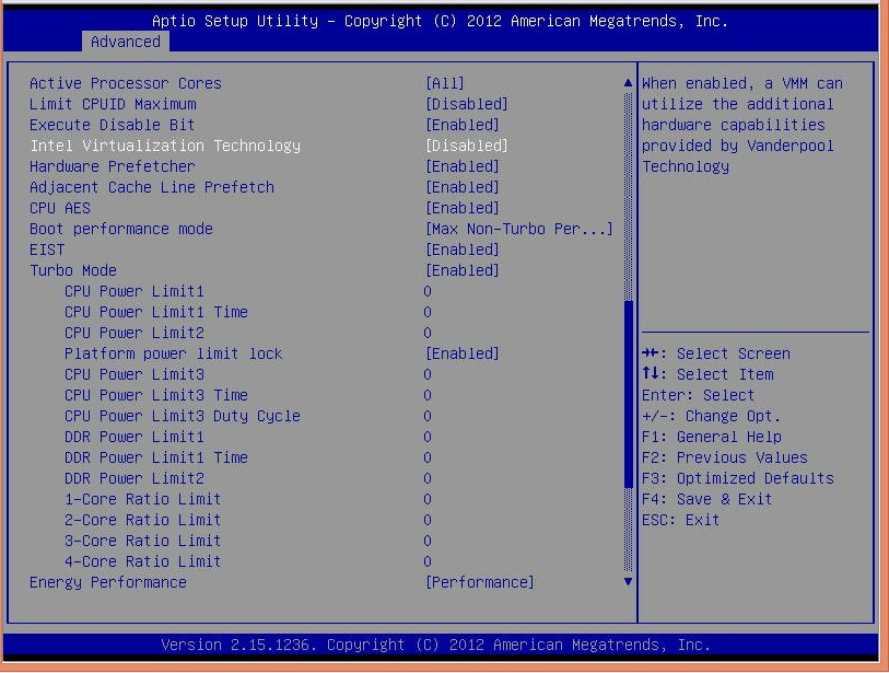

Can do, I'll make the change before I go to bed. Is this based off a theory or its just standard troubleshooting? Another user is having the same issue, hopefully he/she posts here as well.
VT-D now disabled, screenshot attached.
Some users have reported that this resolves issues related to crashing with specific SATA controllers.  Just want to see if that's what we have here.

Just FYI, based on your screenshot, you may not have VT-d disabled. "Intel Virtualization Technology" and "Vanderpool Technology" typically refer to VT-x, not VT-d. Depending on the mobo manufacturer, the two different options can be in different places in the BIOS. You should search the rest of the BIOS for VT-d.
