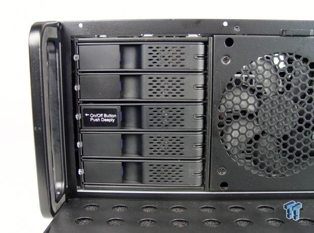

Note that these enclosures require THREE SATA power connectors -- all 3 must be connected for proper operation.  In addition, there's a small power switch for each drive at the top of the enclosure in front (where the indicator lights are).

I have the 973 version. The blue LED's are power buttons, make sure they are turned on. See attached picture.
As mr-hexen noted, the power buttons are the blue LED's.  I suspect that the issue is you simply haven't turned on the drives.
