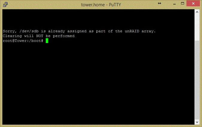

Can you post a screenshot of your telnet session where you try to preclear and it fails? Something is getting lost in translation.
Assuming you haven't rebooted, because /dev/sd? assignments can change from boot to boot, you should be typing something like ./preclear_disk.sh /dev/sdb and typing Yes when asked to proceed. The Yes must have the capital Y.
Here is my screen shot

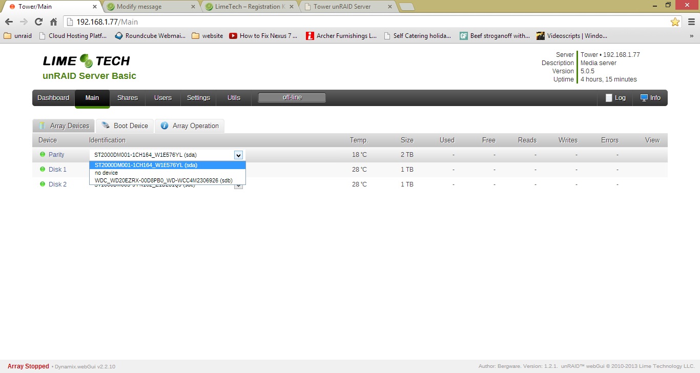

If I stop the array. I have change the parity drive to my new drive, but I dont want to click it in-case its messes up.
Ok, I see now that the preclear script is really convinced that /dev/sdb is part of the array, is it possible that you assigned it to the array and then took it back out? The preclear script looks in a few places to see whether a disk is already assigned, and it looks like the drive is in one or more of those lists.
No its a new a drive. I have 3drives now n only basic key so can't assigned more than 3 drives.

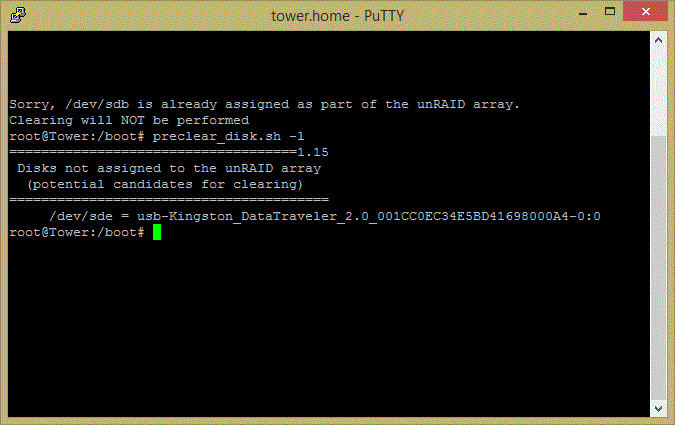

ok I have just been playing around with it.
I stopped the array then tried to preclear.
I got this.
The usb kingston is my usb drive that with SNAP
I have sorted it, i think.
Stopped the array
clicked the "new config"

So did you get this sorted Zacburgess? If somehow the sub drive had at one time been assigned to the array then it would not allow a preclear. Setting a new config should remove this flag from the sdb drive.
