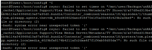

It seemed to run OK, once. Now, I keep getting "Rsync failed to set times" over and over again until it just stops. What am I doing wrong?
Failed to set times is either a permissions error or more likely the file that was there no longer exists.  Can you post the complete log of the rsync
It's REALLY long, but this is what it seems to do over and over again
Originally you said it was failed to set times:
There is a variety of reasons it could be happening.  I had the same issue even tho the files were being transferred.  I ended up adding -O to the rsync parameters to Omit times.  I like clean logs.
Just verify the newer file is syncing right.
On the "no such file or directory" part I ran into that when the file I was copying to was no longer there when it was trying to compare.  By this I mean the machine your copying (rsyncing) to.  The Rsync db has it from before so when its comparing if the newfile is newer than the old the one it has as old doesnt exist.  Does that make sense?
How long is the filename? That could be the issue.
Maybe shorten the path or use a symlink temporarily.
How long is which file name? It's backing up the whole cache drive. So there's quite a few long named files. Plex likes long file names.
