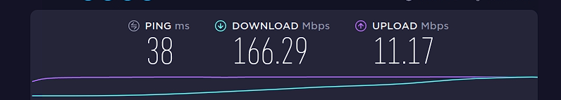

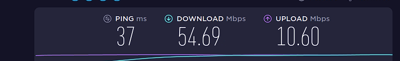

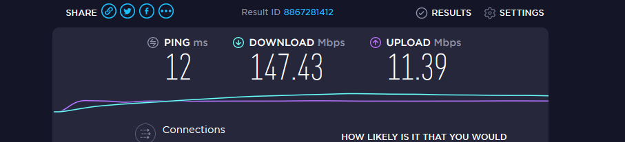

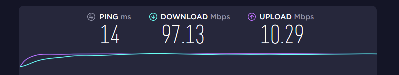

57 minutes ago, blinside995 said:
Fair enough. WireGuard was incredibly simple to deploy.
How is the performance? Does it cover the entire server or does it work like the OpenVPN plugin and only affect dockers?
15 hours ago, deathscreton said:
I was not aware this was an option. This would have been nice to know much earlier.
It was mentioned in the release thread for 6.8. Everyone should read the release thread before updating.
And there is a guide to setting it up. Lots of ways to set it up. It can even cover your whole LAN.

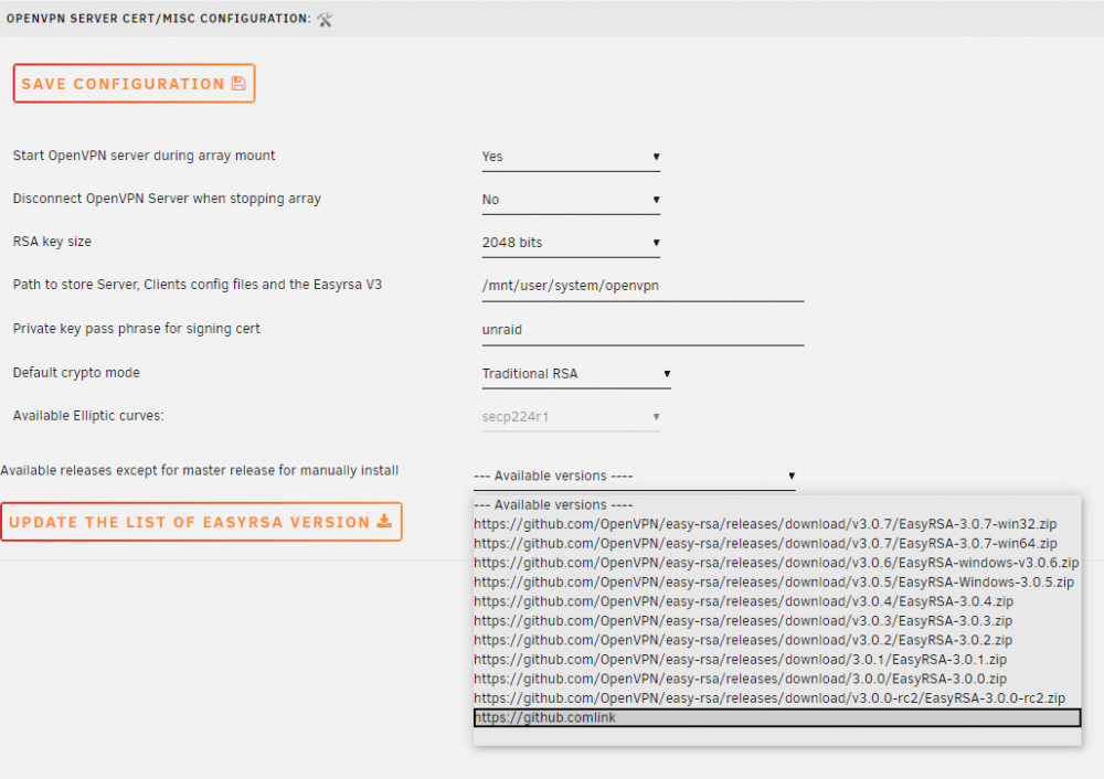

Hi everyone,
i have a Problem downloading the EASYRSA Version. I think the release list is the problem, see screenshot. I tried to change easyrsa_version_full_path.txt, unfortunately without success.
root@srv:/usr/local/emhttp/plugins/openvpnserver/scripts# rc.openvpnserver download_easy-rsa
https://github.comlink
master.zip
Going to download ....https://github.comlink
--2020-04-26 22:13:12--  https://github.comlink/
Resolving github.comlink (github.comlink)... failed: Name or service not known.
wget: unable to resolve host address ‘github.comlink’
<190>Apr 26 22:13:12 rc.openvpnserver[11151]: Deleting the client folder and files when new easyrsa are insatlled.
unzip:  cannot find or open master.zip, master.zip.zip or master.zip.ZIP.
mv: cannot stat 'easy-rsa*': No such file or directory
chmod: cannot access 'easy-rsa': No such file or directory
https://github.comlink is not a vaild link
Thanks for help

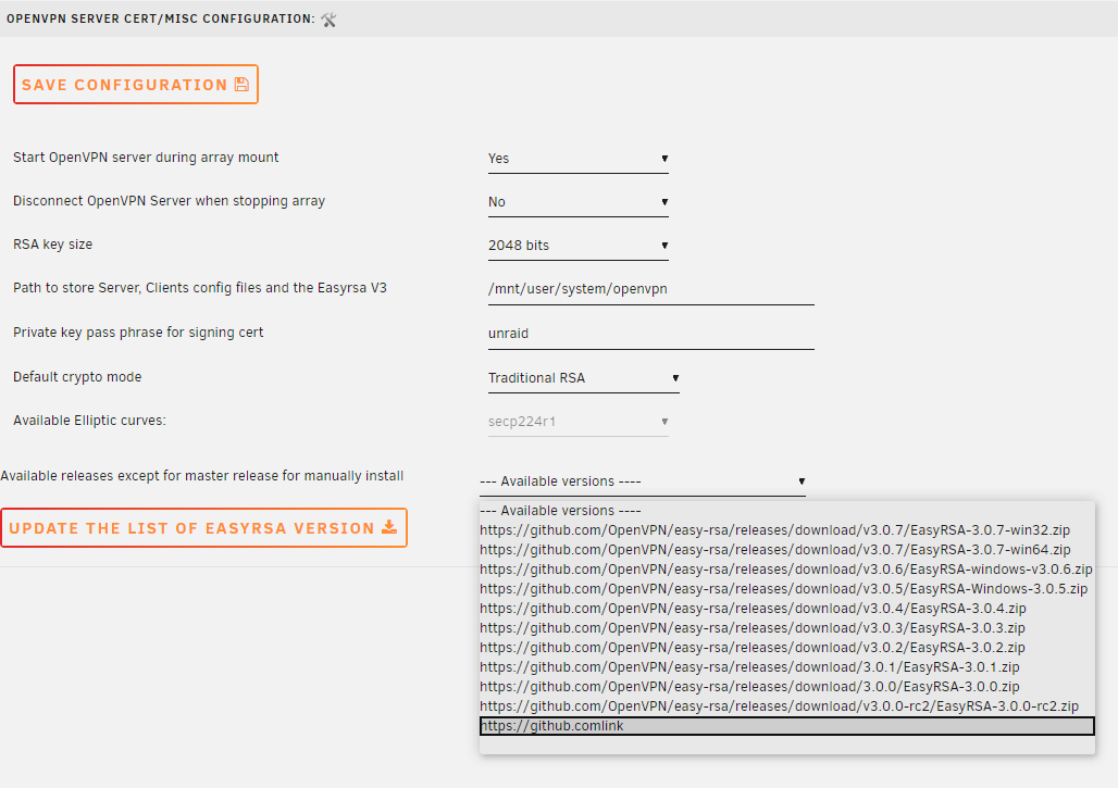

Hi everyone,
master.zip
Thanks for help
There have been som updates on their GitHub pages. An update is now released.

Have not time now to update... but some changes on githup page and to fix this you can for now try to update the script --> /usr/local/emhttp/plugins/openvpnserver/scripts/rc.openvpnserver
Line 349  change f16 to f14
Line 376 change f16 to f14
Amazing! Thank you so much Peter, now working perfectly! 🙂
