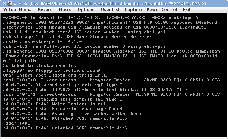

Having performed the upgrade by pasting the text, the update, apparently, completed, and there was a message saying reboot required.  I stopped the array and selected reboot (all from the web gui), but the machine will not boot now.  The console repeatedly displays:
Loading /xen... failed!
No files found!
boot:
No files found!
boot:
I would download the b10a from the Limetech website and copy it over to your flash.  Sounds like your update didn't work.  Missing Xen from the flash?
So it would seem ... I'm able to boot without Xen.
Nope .. spoke too soon, booting without Xen hangs with the attached image displayed on the console.
Seems like something went seriously wrong while writing the images to the flash drive.
Time to open my machine up to get the flash device out ....
