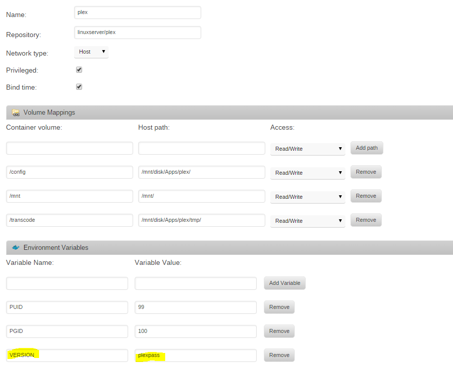

Can the docker use plex pass? I don't see any mention of a username/password
Just FYI, now a days, I use this plex docker:  https://registry.hub.docker.com/u/linuxserver/plex/
And you log in once its up/running vs in the configuration.  Notice the highlighted part to pull the plexpass version. I also force my transcode directory onto my ssd app drive.
That doesn't work anymore....  see here: https://www.linuxserver.io/index.php/2016/04/07/changes-to-our-plex-docker-container/#more-1642
