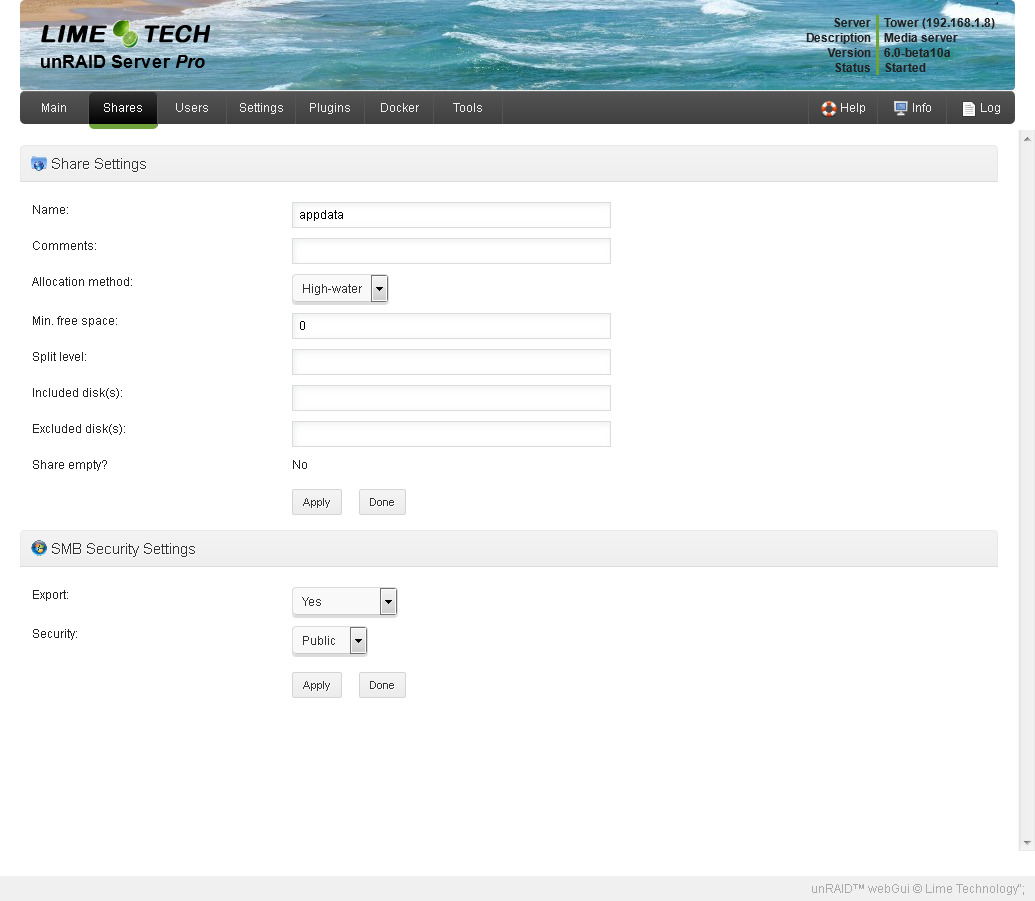

I can't find this:
First, go to the share settings and set "Use cache disk:" to "Only" for the appdata share
this is what my appdata share settings look like (see pic)
Assuming you have an actual cache disk, you might need to enable it. That'd be under Settings->Share Settings. Once you've done that, you might want to look at all your individual shares and set the "use cache disk" appropriately.
thanks for the help. I have enabled cache, moved the folder/files for the share to cache disk and it now it shows "red" (thought that was bad at first lol). Restarted Plex and it seems to be okay.

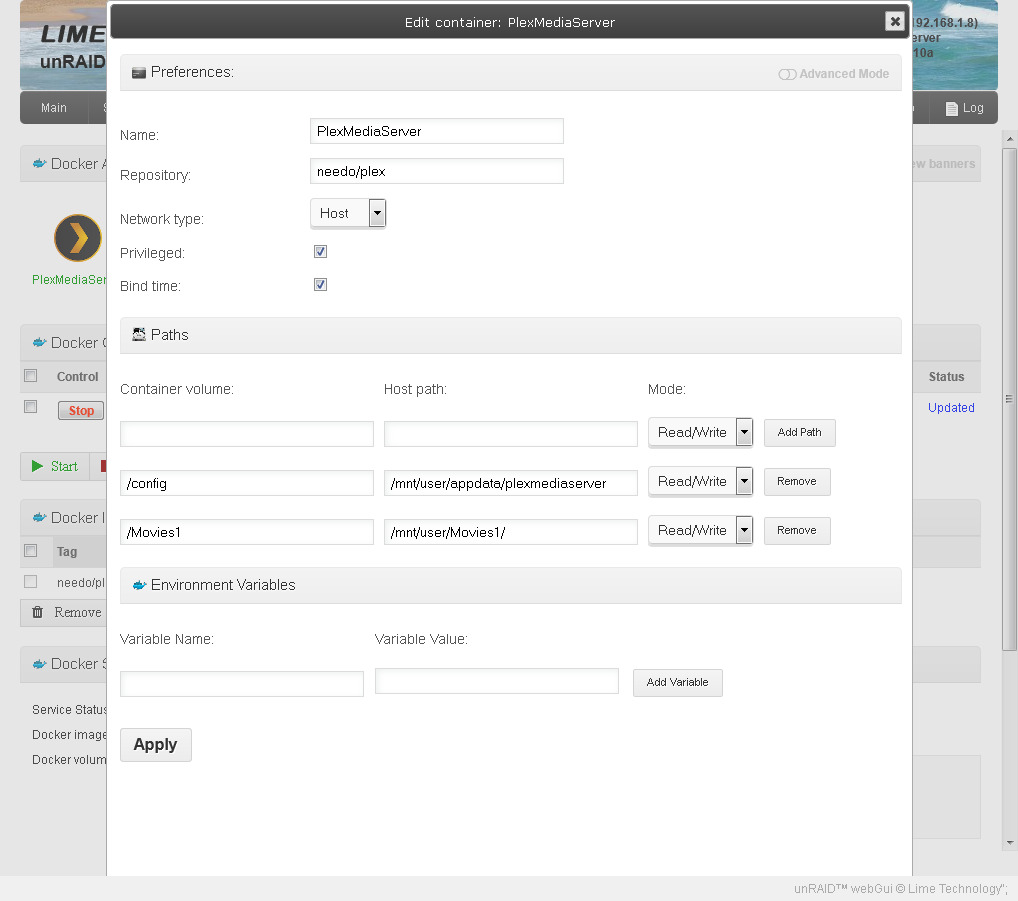

And here are the simple steps to doing this in a container:
Add needs Plex container and add a container volume of /transcode and map that to the host to /tmp
Goto the link referenced in the previous post and on the setting for transcode directory, type /transcode.  Done.
