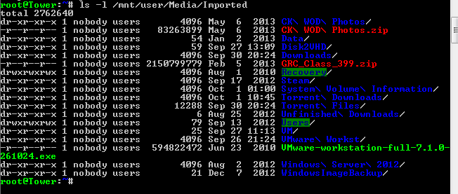

I would suggest that you post the output of a command of the form
ls -l /mnt/user/sharename/path
run from a console/telnet session.  That would allow use to see the underlying Unix permissions.  Also a screen shot of the GUI page for the relevant share settings might be useful.

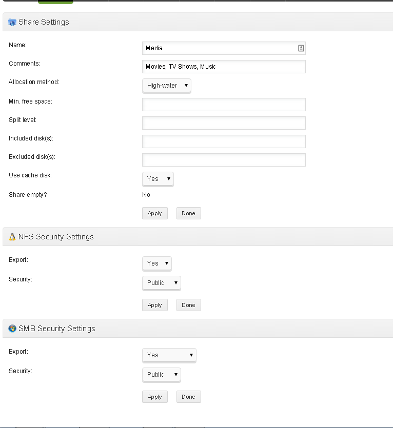

Ok I added the output of the command. I also added screen shots of the share settings and the screen package I installed from package manager in unMENU. I see that utempter was installed along with screen.
folder_permissions.txt
According to the syslog, the screen and utempter packages being installed are not the versions shown in your screenshot.  The screenshots show the 64-bit versions while the syslog seems to show the 32-bit versions.  You might want to check what is present under /boot/packages.
Nothing obvious in the 'ls' output that might cause issues.
The screenshot for the share settings seems to be the wrong one ???
My bad. I got the right one this time. I also added a screen shot of the package folder on the flash.
The screenshot of the packages folder shows that you have both the 32-bit (the files with i486 in their name) and the 64-bit ones.  I would think that the 32-bit ones should not be present.
The share settings look fine.  Cannot see any reason why you are having issues.

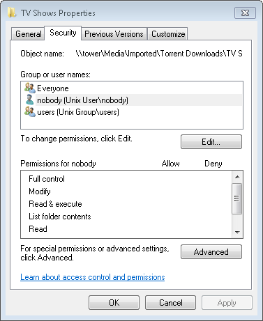

It's strange I have full access to the root folder and can delete files from there  without a problem but if I try to delete any thing with sub-folders or the sub-folders themselves I get a permissions error message. When I look at the NTFS permissions on those sub-folders it says no users have any permissions on those folders.
On taking another look I notice that the folder permissions do not have the 'w bits set.    On my system they are all set on the folders.
It might be worth trying something like
newperms /mnt/user/Media/
and then see if the permissions shown by the 'ls' command used earlier have changed?
That seems to worked for two of the sub-folders but the rest stayed the same.
Weird - I am not sure what governs this.  The one thing I note is that those folders where the 'w' bit was at all levels after doing newperms already had it at one level.
You could try setting the write bit explicitly picking a folder where you want to manipulate the contents and using a command like
chmod -R +w /mnt/user/Media/Imported/foldername
and see if that resolves the issues for that folder.
