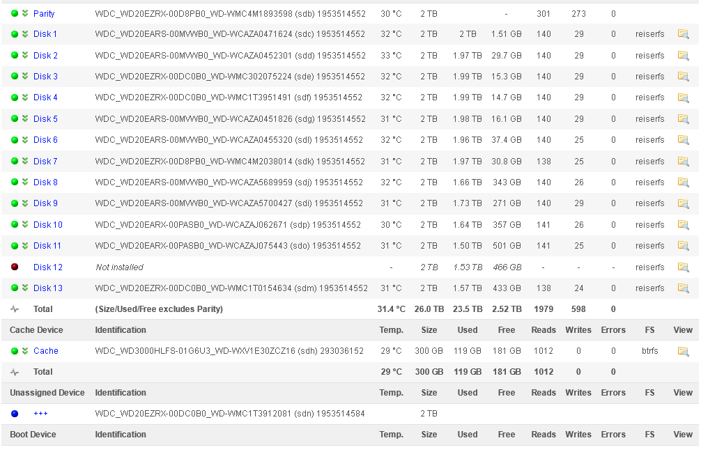

Not wanting to risk losing data, I shut down and swapped the disks back around (2TB back to parity and "failed" drive back in as disk 12, reseated the data cable on disk 12 (connected to AOC card) and restarted. One thing I noticed was the AOC-SASLP-MV8 didn't do its post on the screen! unRaid booted up and all the drives are visible but now disk 12 slot is "not installed" and suspect 2TB is "unassigned" (see pic).
What is my next step? I am pretty sure "new config" will wipe out my data? Have attached 2 syslogs, one was of the disk fail, the other the reboot attempt at swap-disable.

I am pretty sure it was a loose data cable. Drive 12 is in slot next the one I added cache drive to couple days ago. May have jostled the cable connecting the cache disk (all 5in3 cages, bottom cage, furthest in the back connector). When I pressed on it got a click feel (locking connectors).

You probably have to routes:
1. rebuild the disk12 disk either on the same disk or another drive from the emulated disk12
2. Start with a new config and use the data from the physical drive 12.
If you are confident in the data on the physical disk12, I would verify the contents with the array offline, and use option 2.  If you put all disks back into the original slots and bring up with parity valid the parity check should clean up a any invalid parity bits.
