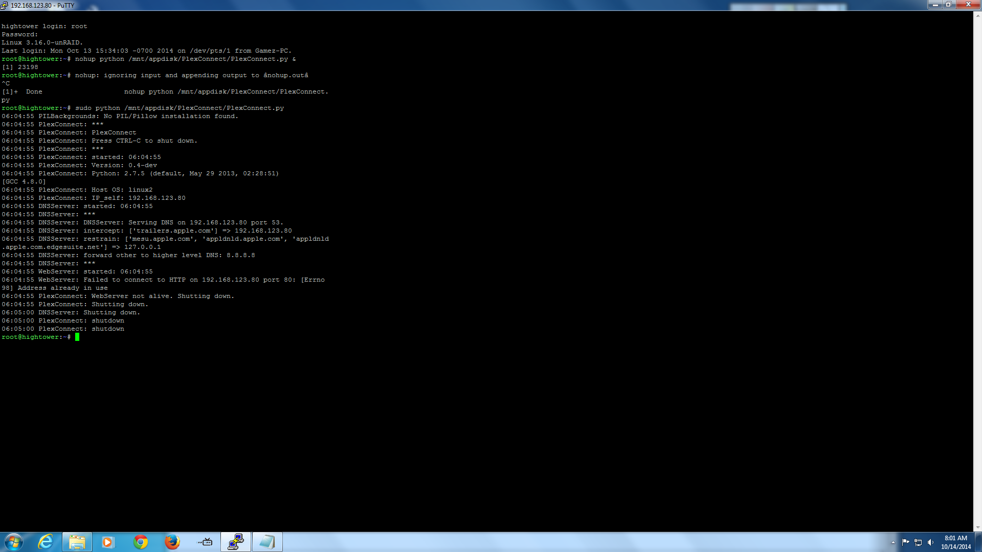

I try to install Plexconnect to my unRAID to use ATV3. I read wiki page and read all discussions try to every combination configuration but It no goes . Any one that installed ATV3 and Plexconnect please give me some light.
My unRAID OS 6.xx 64 bit
Install Plexserver  --- work
APC                    --- work
Cached dirs          --- work
Plexconnect    (use 64 bit .plg plugins)  ----- install with out error ( status is running)
ATV3  installed certification.
when I start up PlexConnect.py in remote login console I get webserver not alive then shutdown
my unRAID ip 192.168.123.80 and port set in go file was 90.
Please see attachment more details
Looks like you still have a port conflict on port 80.

when I start up PlexConnect.py in remote login console...
You don't need to touch the console or command line at all.
Maybe you are getting the port error because you are starting a 2nd instance of PlexConnect from the console?
Also, when you start PlexConnect, it will generate a Plexconnect.log file in the Install directory you specified on the plugin GUI setup screen.  That will indicate if PlexConnect starts up without issues on any of the ports before you even try to connect from your AppleTV device.

I think you may have a certificate issue.
Delete any certificates you may have loaded on the AppleTV.
1. Go to the AppleTV settings menu.
2. Select “General” then scroll the cursor down to highlight “Send Data To Apple” and set to "No".
3. With "Send Data To Apple" highlighted, press “Play” (not the normal “Select” button)
4. Highlight any profiles that are shown, press Select, and then "Remove Profile"
Generate new certificates following this guide:
https://github.com/iBaa/PlexConnect/wiki/Install-Guide-Windows-Certificates
Make sure to copy the new certificates to your PlexConnect install folder and delete any existing older certificates you created
Install the new certificate on your AppleTV:
3. With "Send Data To Apple" highlighted, press “Play” (not the normal “Select” button) and you will be prompted to add a profile.
4. Enter (without the quotes): "192.168.123.80/trailers.cer"
From the PlexConnect WebGUI restart PlexConnect
Try launching Trailers on the AppleTV
Hi jevans04,
After I re-certificate ATV3. ATV3 start to stream video from Plexserver. Everything is working ok as other devices in my house. Without your help, I am not able to make ATV3 to work with PlexConnect and I will drop this project. Thanks you very much for your times and your effort to help me out and point to me right direction to go. Thanks again Jevans04.
I was happy to help and glad to hear it's working now.  :)
