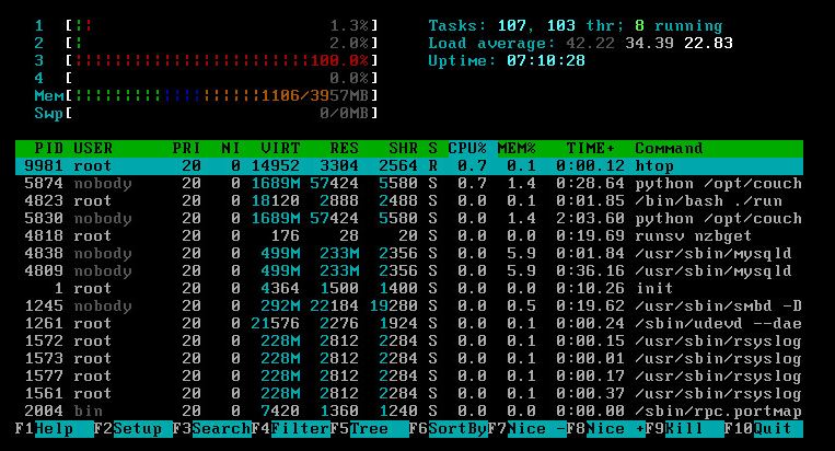

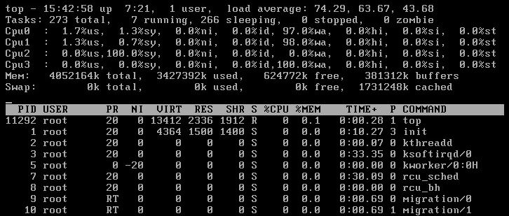

Both GUI and SMB are not accessible. Running "ls /mnt/user" froze while I am in via putty froze the terminal. The vmware console is still accessible.
I've attached two screenshots of htop and top running.
I'm not sure if this is a unraid issue or esxi issue as it appears to be pointing to the CPU...

I have to wonder if we aren't dealing with another Reiser bug here, due to the recent Reiser code 'refactoring'.  My gut feeling here though is this could be a kernel bug, which will be fixed by a later patch, Linux kernel 3.16.4 or later?
It looks like the CPU stall triggers a debug state where the kernel logs exactly what each CPU is doing every 3 minutes.  Perhaps this is configured somewhere?  It does allow us to see that most of the CPU's are almost always idling, but CPU 3 is stuck in Reiser code.
Sep 27 04:36:33 phatstore kernel: [<ffffffff81162801>] reiserfs_xattr_set+0xd2/0x114
Sep 27 04:36:33 phatstore kernel: [<ffffffff8116311b>] user_set+0x3f/0x4d
Sep 27 04:36:33 phatstore kernel: [<ffffffff81162bb2>] reiserfs_setxattr+0x9b/0xa9
Sep 27 04:36:33 phatstore kernel: [<ffffffff8110b981>] __vfs_setxattr_noperm+0x69/0xd5
Sep 27 04:36:33 phatstore kernel: [<ffffffff8110ba69>] vfs_setxattr+0x7c/0x99
Sep 27 04:36:33 phatstore kernel: [<ffffffff8110bb9e>] setxattr+0x118/0x162
Maybe there's another reiserfs bug in the extended attributes code.
Something that bitrot exercises allot. I.E. It puts data into the extended attributes.
I know the rsync does a copy with extended attributes also, but there shouldn't be all that much in the cache extended attributes.
Unless purposely put there.  i.e. bitrot or AFP(I believe)

AFP and NFS have been turned off and I've reassigned all CPUs on ESXi to be one less than the max available.
Unraid froze again during the mover script. Here are the syslogs and "ps -ef" logs.
Looks like CPU & Reiserfs causing the kernel panics:
Oct 17 03:20:43 Tower kernel: INFO: rcu_sched self-detected stall on CPU { 1}  (t=6000 jiffies g=1676792 c=1676791 q=19435)
Oct 17 03:20:43 Tower kernel: sending NMI to all CPUs:
Oct 17 03:20:43 Tower kernel: NMI backtrace for cpu 1
Oct 17 03:20:43 Tower kernel: CPU: 1 PID: 15800 Comm: shfs Not tainted 3.16.3-unRAID #3
Oct 17 03:20:43 Tower kernel: Hardware name: VMware, Inc. VMware Virtual Platform/440BX Desktop Reference Platform, BIOS 6.00 04/14/2014
Oct 17 03:20:43 Tower kernel: task: ffff8800a7e156a0 ti: ffff88009a048000 task.ti: ffff88009a048000
Oct 17 03:20:43 Tower kernel: RIP: 0010:[<ffffffff81032618>]  [<ffffffff81032618>] flat_send_IPI_mask+0x77/0x86
Oct 17 03:20:43 Tower kernel: [<ffffffff81143592>] ? reiserfs_discard_all_prealloc+0x37/0x4c
Oct 17 03:20:43 Tower kernel: [<ffffffff8114359e>] ? reiserfs_discard_all_prealloc+0x43/0x4c
Oct 17 03:20:43 Tower kernel: [<ffffffff8115f8d2>] do_journal_end+0x4e1/0xc57
Oct 17 03:20:43 Tower kernel: [<ffffffff811605a2>] journal_end+0xad/0xb4
Oct 17 03:20:43 Tower kernel: [<ffffffff81150eca>] reiserfs_dirty_inode+0x6c/0x7c
Oct 17 03:20:43 Tower kernel: [<ffffffff81095450>] ? from_kuid+0x9/0xb
Oct 17 03:20:43 Tower kernel: [<ffffffff8110dfb2>] __mark_inode_dirty+0x2f/0x1de
Oct 17 03:20:43 Tower kernel: [<ffffffff8114cd1a>] reiserfs_setattr+0x262/0x294
Oct 17 03:20:43 Tower kernel: [<ffffffff810f1b45>] ? __sb_start_write+0x99/0xcd
Oct 17 03:20:43 Tower kernel: [<ffffffff810fc109>] ? user_path_at_empty+0x60/0x87
Oct 17 03:20:43 Tower kernel: [<ffffffff81105492>] notify_change+0x1dd/0x2d1
Oct 17 03:20:43 Tower kernel: [<ffffffff81112014>] utimes_common+0x114/0x174
Oct 17 03:20:43 Tower kernel: [<ffffffff8111215f>] do_utimes+0xeb/0x123
Oct 17 03:20:43 Tower kernel: [<ffffffff811122ff>] SyS_futimesat+0x8a/0xa5
Oct 17 03:20:43 Tower kernel: [<ffffffff8111232e>] SyS_utimes+0x14/0x16
Oct 17 03:20:43 Tower kernel: [<ffffffff815df469>] system_call_fastpath+0x16/0x1b
