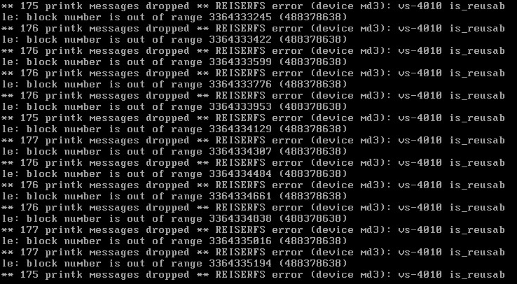

I too am having the exact same issue.  I have been running Unraid ver 5 with no issues for the past year under Esxi.
I upgraded to unraid ver 6 when it entered public beta, again with no issues.  However past beta ver 6, after an average of 2 days, the webgui would not be accessible,  nor the user shares.  However I did have access to SSH and direct access to the virtual machine in Esxi.  The unraid server would not respond to console shutdown commands or commands to restart Unraid.
I thought it might have something to do with the mover script.  Once the mover script finished running, access to the webgui became noticeably slower if it was accessible at all.  Running the mover script twice pretty much guaranteed a problem.  I thought, well I can do without a cache drive, however turning off all access to the cache drive did not 'fix' the issue, only added a little bit of time before the gui stopped responding.
After downgrading back to unraid 5, once again I have not had any issues.
Was so excited to see beta 12 be released, but I am disappointed to see this bug still exists.  I wish I could put beta 12 up and grab some of the log files from my server to help diag this issue, however having the media server go down randomly is not something I am willing to risk.

Decided to boot into Arch and start Unraid-6.0b12 under Xen 4.4.1 and try the following:
  • Ran the Mover script which moved 10GB of data
  • Ran the bitrot script "bitrot.sh -a -p /mnt/disk4/TV/ -m *.mkv"
  • Updated a docker image which live on the cache drive
And so far so good. I know that when I ran "bitrot.sh -a -p /mnt/user/TV" it gave me a kernel panic the minute it started putting the SHA256 into the file itself.
I am monitoring the syslog both via the browser and "tail -f /var/log/syslog" and so far so good. This is the longest Unraid and the bitrot script has ever lasted.
Bitrot script was able to process 94GB successfully under /mnt/disk4/TV and another 50GB under /mnt/disk12/Anime..
Here comes the real test: "bitrot.sh -a -p /mnt/user/TV/ -m *.mkv" Let's see if Unraid has a (CPU) panic with this.
So right when it started the bitrot accessing /mnt/user/TV and watching XBMC at the same time it decided to panic:

If I browse \\tower I see all of the unraid shares but I am unable to browse to \\tower\TV as it freezes Explorer
Browsing via SSH has the same issue. I can see /mnt/user/* but going to /mnt/user/TV freezes Putty
XBMC is unable to find the files to play
I notice that it "stalled" on shfs. Any way to debug or troubleshoot if it's shfs causing this issue? I'm guessing that's why it didn't freeze when moving files between /mnt/disk(1-13) since it bypasses shfs.
Just went through the changelogs and noted only the changes to "shfs"
Snce the past few stalls have been pointing towards shfs and noticing that it only freezes when the Mover (which uses /mnt/user and /mnt/user0) and Bitrot script (when using /mnt/user/TV) is running than it has to be something with shfs.
When I manually copy 100s of GB of data via MC or run the bitrot script against /mnt/disk(1-13) it doesn't have any issues, hell, I can even watch shows via XBMC, copy data and run bitrot without issues.
Please correct me if I'm wrong as I'm trying not to jump to conclusions but I believe I've narrowed it down to shfs...

I think I am having the same issue you're having but I am not running under ESXi, bare metal in fact.
The problem started once I reached beta9 but I think thats just coincidence. You can see my thread here: http://lime-technology.com/forum/index.php?topic=35357.0 but its probably not necessary.
My theory is that since I write alot of data to my server, probably 100-200GB a day I have been caught by the RFS bug that beta 7-8 had. For the last few months my server has frozen roughly twice a week. Webui cannot be accessed, nor can shares etc. but SSH can unless I try to list something under /mnt meaning I have to do a hard reboot.
Currently I am moving all my drives to XFS which i have calculated will take about 15 days.

So perhaps there is some internal RFS corruption causing the issue.
I wonder if running a scrub on the filesystem itself will reveal it.
I did this recently on a live filesystem (Fills all empty space with data) to reallocate some pending sectors. It worked for that usage case.
In this case, I wonder if it will reveal problems in the metadata enough to cause a problem.

Right after I ran "scrub -X /mnt/disk3/tmp -p verify" I received this error message.
Unraid locks up and can't do anything which forced me to hard reboot.
Status:
Disk1 scrub passed.. no issues.
Disk2: Currently running right now
Disk3 scrub froze and had reiserfs issues from the syslog

It seems like there is some corruption at the reiserfs level.
FWIW, we know for sure beta 7 & 8 had the potential for silent corruption at the reiserfs level.
If you ran those for an extended time and wrote to the filesystems issues could have grown from there.
Do you have md5sums of each drive to verify integrity?
Does this happen on unRAID 5 on that specific drive?
What about outside of ESX.

If I find out what drives are corrupted by running the scrub command.. should I try and convert those over to XFS? Or is there another way to fix the silent corruption issue?
I suppose you could try doing the reiserfsck on the drive in question, but no one really knows how bad the corruption is.
Before I did anything, I would try to copy/rsync at least 1 disk to a newer XFS disk.
At that point you can migrate to XFS for other drives, or attempt to fix the disk giving you issues with reiserfsck.
That's a learning experience in itself.  It's like do I **** or get off the potty?
Given the maintenance and the future of reiserfs, this may be the impetus for you to get off reiserfs completely.
Frankly we don't know where the corruption came from. Beta7,8 or other ESX related crashes thus causing issue on the filesystem in question.
I.E. Did this problem start with reiserfs corruption?
or did ESX cause unRAID to fail abnormally, this causing the reiserfs corruption.
I've seen any form of power failure cause corruption on filesystems.  Usually they fix what they can during a fsck.
The only way to 'safely' determine this is to copy what you can to another drive (do not write anything if you do not have to).
go bare metal or go unRAID 5 and test the questionable filesystem.

In dealing with all of the recent issues with reiserfs, I've been wanting to move to XFS and this is my push to do so. I've been baffled with the choice of ReiserFS due to it no longer being "officially" supported anymore. No amount of people can really replace the dude (and company) who created it and knows it best.
In regards to the corruption, I never had any major issues until after beta6. This I know for a fact because I've never had a single lock up or freezing until after beta6. My ESXi box has an APC attached and only has had a power failure two to three times in the past 5-6 months due to the power going out in my apartment for 3+ hours and my damn script not shutting down Unraid properly. I have 3 other workstations on my ESXi box (RDP, Mediaserver and Arch linux box) that have never had any corruption issues. ESXi has been rock solid and I've pretty much set it up just like I've done in the enterprise world (minus SAN/iSCSI.. that's coming much later in 2015)
I will be rsyncing disk3 over to another drive, formatting it to XFS and rsyncing it back. I will then do another scrub test just to verify that it's working as it should.
I'm happy with the results from this forum and thank everyone for reading/following along.. I also don't want to come across like I'm blaming Unraid for the data corruption and nothing being done to resolve it seeing as it's a wide spread issue that was fixed months ago: https://bugzilla.kernel.org/show_bug.cgi?id=83121
Did you use beta 7 or 8. It's a known there were reiserfs bugs with silent corruption on those versions.
This could all be stemming from that.
In the same array? I would not rsync it to another reiserfs disk.
I would acquire a new empty disk, format it as XFS and rsync from reiserfs to XFS, not back and forth.
Who knows how deep the corruption lies

Alright... Well here's my progress so far:
Moved everything off disk3 and onto another computer and formatted the disk to XFS. After formatting it XFS, I ran the scrub command for ~30 minutes just to see if it would crash, and it actually kept going. When running scrub with ReiserFS, Unraid would crash within 2-3 minutes. So I rsycned another drive to Disk3 and so far it's written 1.45 TB and has 2,801,338 writes on it so far. And it's going strong, averaging between 50-90 MB/s.
I think all of my crashing has to do with the ReiserFS corruption issue. So I'm now in the process of converting every drive I have to XFS. I'm very tempted to do BTRFS instead but I'm a little hesitant since it's still considered "experimental." I love living on the bleeding edge but I don't think I want to deal with any BTRFS issues anytime soon.
