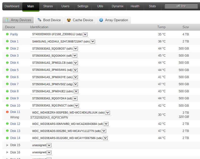

Attached the screenshot of my attempt to swap the 320GB drive, showing the 4TB replacement identified by webgui as a 3TB...

Then I moved it to a different sata connector (slot) and there my troubles began. It is like UNRAID has rewritten the description of the drive when I moved it and it is now seeing it as a 3TB drive no matter which slot I place it in.
