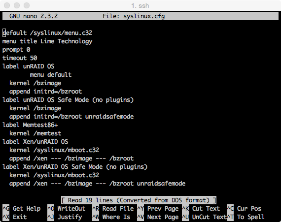

i just updated to 6 beta 15 and i don't see the kvm next to the docker.
but i also notice that im boot Xen/Unraid, do i need to change it to regular unraid for it to appear/

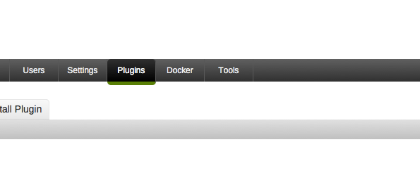

well i made the changes but no kvm tab
Did you remove this plugin? You need to install this plugin. Leave the plugin folder on the flash drive though. It's been included in b15 along with a ton a changes. Also under Settings/ VM  manager. Set enable VMs to yes.
Never had it, this is my first kvm setup, i just found where you enable it. (DUH). and it magically appears after you press apply Yeah, so im going to venture on my first VM.

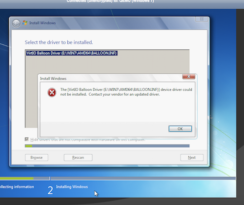

i got the correct folder but got these errors.
could i have a bad iso of the vir drivers?
I really appreciated the help.
I don't see any errors. All I see is the install for the virtio memory balloon driver. Which is for supposedly setting max mem to a higher value than current mem.  And it will balloon as needed.  Not sure it works though but installing the driver is ok.

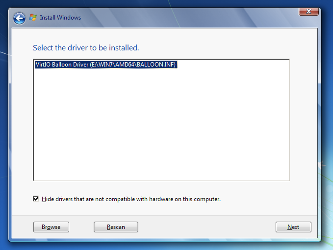

Did any other 64bit drivers install correctly? Which virtio drivers did you use? Stable version 81 or latest 100?  If stable you can click on parent directory and goto latest.
Well initially she. I just click ok to find drivers 3 of them installed. Then when my disk didn't show up I tried to browse to the directly of amd. 64 bit and tried both that appeared under that folder. One installed and the other have me the error.
I will re-download try again

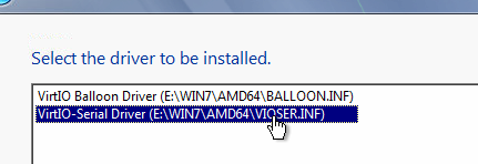

i redownloaded it and tried again, I installed the following driver (see picture) I even tried the x86 still no drive.
Not sure what i am doing wrong.
FYI vm's are going to be on my cache drive.

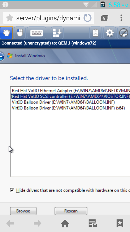

You need the virtio scsi driver viostor.inf
Awesome, thanks that did it. where is the buy me beer button?
