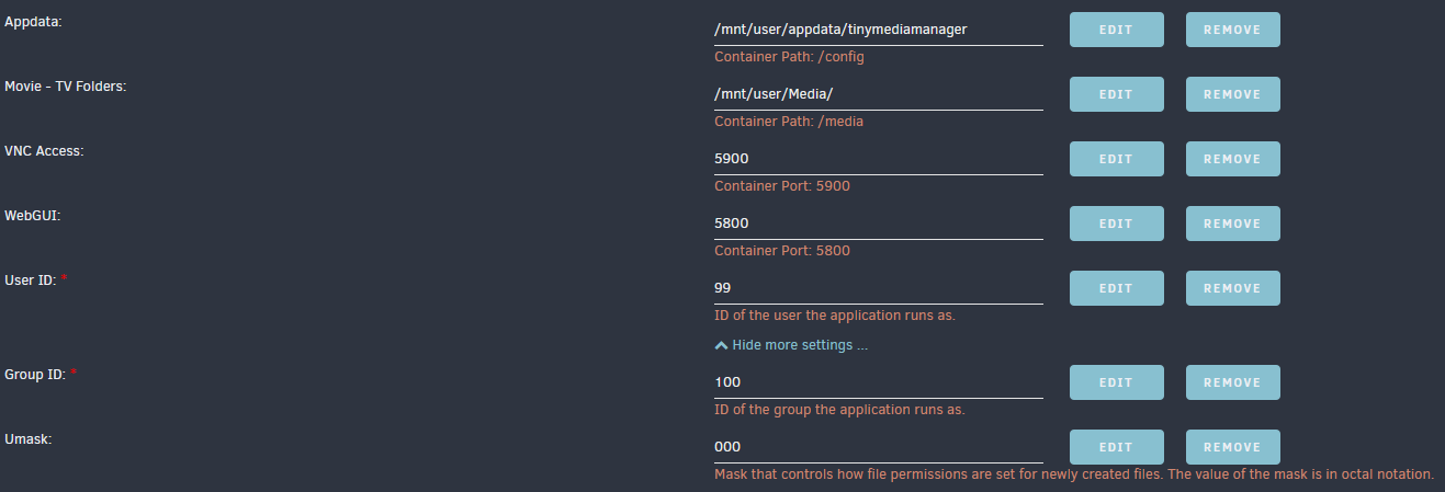

I pretty much just copied / pasted everything that was in the Krusader docker and slapped it into the TMM docker.
For future reference, in case anyone else has the same issue, these settings allowed me to delete the .tobedeletedTMM folder off of the array regardless if the Docker container is started/stopped etc
