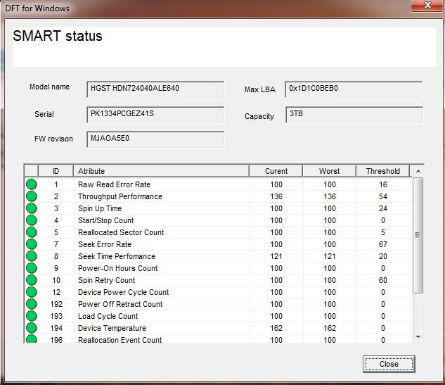

I installed WinDFT (HGST tool) to review SMART data.  First I found that the HGST application WinDFT was recognizing my drive as only a 3tb.  The really bad part is that my brand new drive has been running for only 2 days and SMART shows;
Raw Read Error Rate = 16
Reallocation Sector Count = 5
Seek ErSror Rate = 67
Spin Retry Count = 60
When I look at my other hard drives, they all show zeros for everything listed above.  This is my first HGST drive, so perhaps this is ok - assuming that the errors are not increasing.  I will have to run it for a couple more days and see if the counts increase.

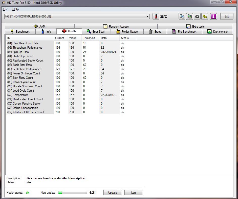

I purchased this drive from B&H Photo so I only have a few days remaining to initiate a return / exchange.  I decided to load up HD Tune Pro and to my surprise, the counts were all different - all errors were gone, zeros.  The weird part of HD Tune is that for the Temp and Spin Up Time, the numbers were clearly not correct, reading into the millions+.
I have attached a screenshot of both SMART screens.
I contacted HGST and again to my surprise, they told me that I should not return my drive because there is nothing wrong with it.  They tell me this after their own WinDFT application reported several SMART errors and even thought my drive was a 3tb instead of a 4tb.  HGST said they will look into why their app isn't reconizing the drive correctly.  When I asked which SMART report is correct, they would not answer me.  If the WinDFT report is correct, then the drive is bad and should be returned - if or nothing else the Reallocation errors.  If the HD Tune report is correct, then perhaps they are right and my drive is fine.  Still doesn't explain why the spin up time and temp readings are all messed up though.

@ c3 - that's just it, the tool says it is bad, but HGST support says it's good.  Their tool is not recognizing the drive correctly, again showing it as a 3tb.  When I contacted HGST support and sent them the same screenshot, they tell me the tool is just not working and the drive is still within specs.  But they would not confirm the errors.  They told me that the drive was still good, and if I did rma it, I would get a re-certified one - when I just paid full price for a new one.  The goal for me right now is to determine if the drive is bad or not, which SMART report is correct.  It's a pain to do the RMA, especially now that I have all my data on the drive.

The values reported are from the "Threshold" column - these are not the actual values.
The posted smart report looks perfect.
The drive is fine.
Super!  So the HGST support guys were right, no issues and they just need to fix their app.  That also means the HD tune was correct, as it showed no serious errors.  Again, many thanks :)
