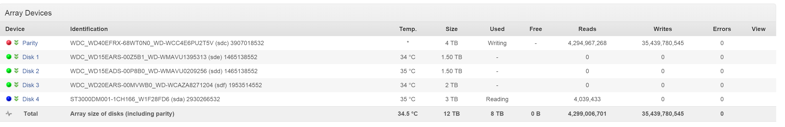

Ok, so I tried reiserfsck on the mentioned sda1, and got this (attached is the newest screenshot I have of my configuration):

For some reason, I can now suddenly access the web gui again. All drives are unassigned, but luckily I have a screenshot, so it should be easy to fix it again.
Still, I wonder what really happened, and how I can, if possible, avoid it in the future.
Edit:
When I have selected the parity disk and two additional disk to slots in the gui, the rest of the options in the remaining slots are greyed out. Anyone know why?
