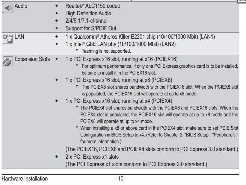

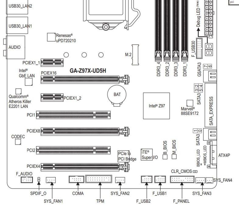

Weebo - Good info and thanks for looking at the details, you confirmed what I have been thinking in terms of the bandwidth availability. This is a new system being assembled and I am still sourcing the parts to it. At this point, I see no reason to cripple the I/O bandwidth availability given what we know. I am going to try and send the unopened Asrock shipping box back and pick up a GIGABYTE GA-Z97X-UD5H board - http://www.newegg.com/Product/Product.aspx?Item=N82E16813128707
This Gigabyte board has 8 sata ports (2 less than ASRock) and if using the M.2 SSD an additonal 2 ports. However, I will be gaining a PCI3 x4 slot (instead of PCI3 x2) and additional 2 PCI slots. Also on a PCI x16 slot, a 8 port sata card should provide up to 8 GB/s bandwidth and with all 8 sata3 ports being used simultaneously they shouldn't be IO throttled. This will give room for any expansion/addition in future if needed. I intend to explore more with VM's, one will be a HTPC+gaming and another maybe a Linux distro. Attached are some snapshots of the board layout and pci specs from the Gigabyte manual. The slots seem to be closer spaced than I would like though.
What do you think?
Edit: for the gigabyte board,  it appears that when the 3rd pci3 x4 slot is used,  the speeds for the other two are also reduced to x8 and x4.

Weebo -  wouldn't the two pci3 x4 slots be equivalent to pci1 x16 slot ~ 8 GB/s for each pci3 x4? There are 3 pci3 x16 slots, 2 Pci x16 slots and 2 Pcie x1 slots.
Alternatively there are two Pci x16 slots. Using a x8 8 port raid card on these ports should yield full max speed for the hdds on these slots?
I was thinking more about limited bandwidth for the video card slot.  I have a R9 280x for the video card slot. My head is starting to hurt thinking about options. If you think this board may not work for what I have in mind,  do you have any recommendations?

In your previous post you mentioned about the pci slots operating in Gen2 mode when the widest slot is occupied, was that a typo or could you clarify more on that? As the Gigabyte manual says, if the last pci3 x4 slot is occupied, the first two lose their bandwidth by half and operate at pci3 x8 and pci3 x4 (the third one also at pci3 x4). So they are still gen3 pci slots and not gen2. So theoretically they should provide pci3 bandwidth at reduced I/O lanes: 4x8=32Gb/s and 16Gb/s respectively -> a M1015 raid card designed for pci2 x8 slot should not be bandwidth limited in a pci3 x4 slot. Is that correct?
I have been looking at the discussion http://lime-technology.com/forum/index.php?topic=16769.0 and the Intel RES2SV240 doesn't seem to be a bad idea eventually if the M1015 will get its full I/O bandwidth in the pci3 x4 slot.
This concept is correct, Yes, x4 GEN3 is almost x8 GEN2,  But the cards are only GEN2 cards, so actual bandwidth is x4 GEN2
(which is enough).
(which is enough).
