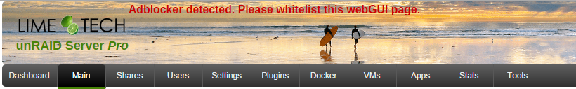

I've created an adblocker detection and put a warning when found active.
Great idea, but can I suggest that you change the message slightly to say that the unRAID server should be whitelisted rather than the specific page?
Also if feedback suggests this is working well maybe it should be made a popup so it is more 'in-your-face and harder to ignore?
Link to comment
I changed the text to Adblocker detected. Please whitelist this unRAID server. Better?
People can choose to ignore the warning, which stays visible all the time, but when it is a popup it will be very irritating.
There is no 100% guarantee that all adblockers are detected. The detection works by placing some "bait" on the page and check its removal, not every adblocker will take that.

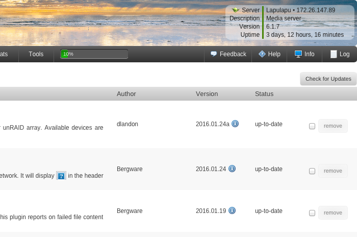

Dynamix Local Master: I've got a strange display issue on the plugins page. See attached picture. Chrome inspect shows: Failed to load resource: the server responded with a status of 404 (File not found). The image does show correctly at the top of the page.
working fine in mine (v2015.12.30). Try deleting cache?
That's not the current version of the plugin. There is a new one 2016.01.24. I have the same issue with the icon on the Plugins page. Don't know if it also affects where that icon gets displayed elsewhere in the UI since my router is my Local Master.
Now updated to latest and icon is displayed for me. Source: http://tower/webGui/icons/localmaster.png

uninstalling and reinstalling the plugin fixed that issue.  But the icon is still not showing up in the Plugin page.
It seems that the location of the little icon has changed. Previously it was
/usr/local/emhttp/plugins/dynamix/icons/localmaster.png
but now it's
/usr/local/emhttp/plugins/dynamix.local.master/icons/localmaster.png
and the change is causing a 404 File not found error on the Installed plugins tab of the Plugins page, though it is being displayed correctly to the left of Server in the top right corner.
