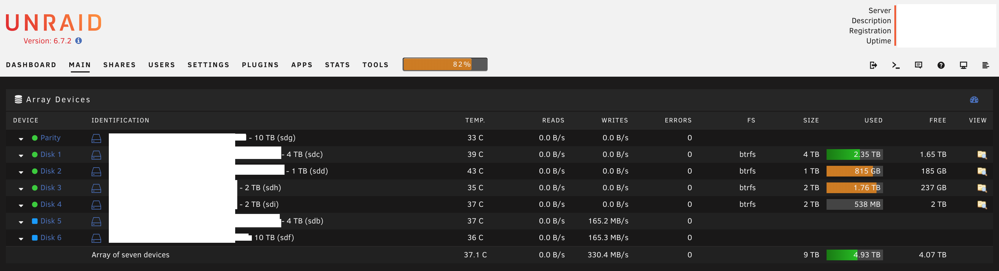

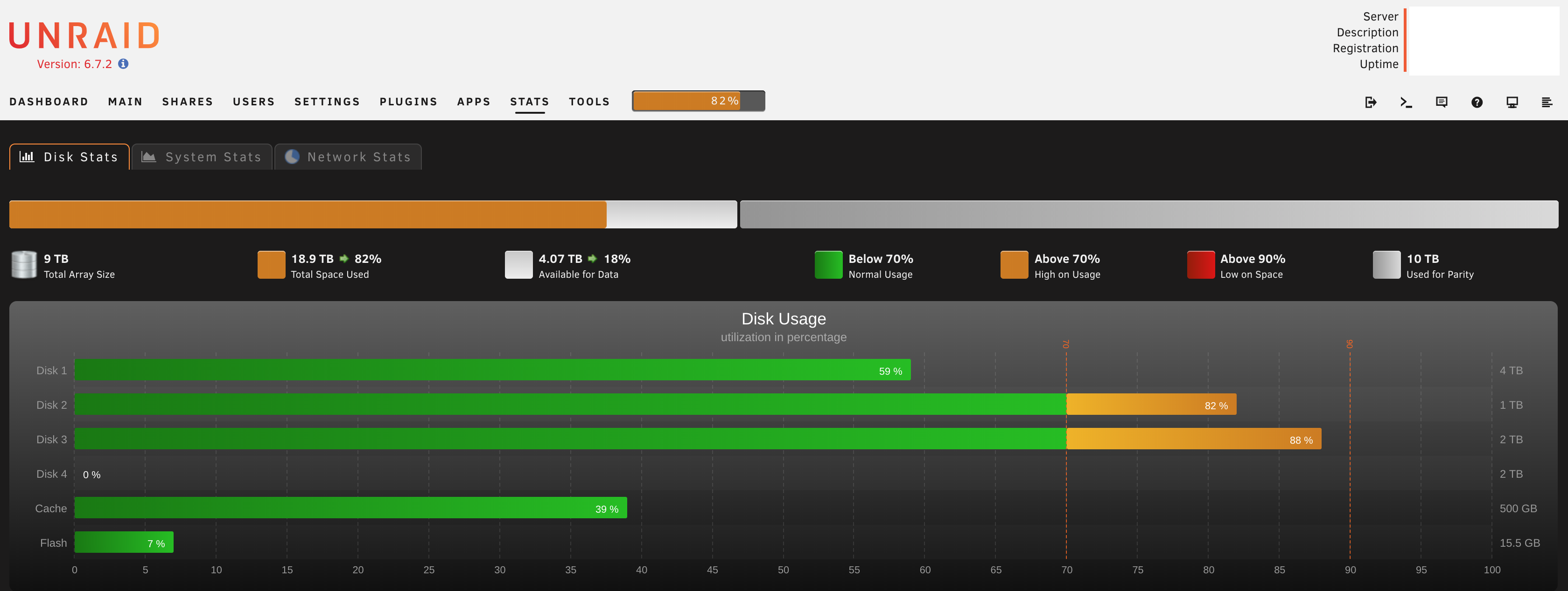

Disk array size and free size calculation seems to be wrong during the pre-clearing of new drives in the array.

Not sure what you think is wrong?    The screen shot seems to indicate that you are Clearing (NOT pre-clearing which is a different operation) the drives and until that has completed and the disks subsequently been formatted their space will not be taken into account.
As itimpi said.
It is not possible to preclear a disk in the array. But if you add a disk that hasn't been cleared to the array Unraid will clear it so parity remains valid. The "pre" part of preclear means clear a disk before adding it.
Share this post
Link to post
Thanks for pointing out the correct unRAID terminology. I have not used 82% of the available space and it is impossible to use 18.9 TB of a 9 TB total array size. Before adding the new drives the total space used percentage was at 55%, when the new drives were added it jumped to 82% during the clearing stage.
Share this post

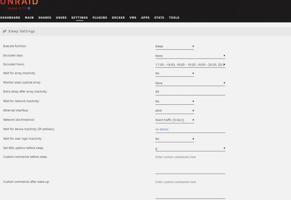

hi,
I need help with the configuration of Sleep plugin.
My Server starts through the bios, everyday at 18:00, and I want that it keeps working for 6 hours and go to Sleep again.
The problem is that I tried all possibilities, and nothing seans to work.
The "Excluded hours:" does not matter, he goes to speep anyway.
The "Wait for array inactivity:" if I dont put as "NO" he keeps awake anyway.
The only thing that works is the "Extra delay after array inactivity:", that could solve it all, but this funcion accepted at most 99 minutes.
I printed my actual configuration.
Someone can help?
Thanks in advance.

15 hours ago, esf said:
The "Excluded hours:" does not matter, he goes to sleep anyway.
Its been a while since i used the S3 plugin, but I thought that the Excluded hours setting was for doing exactly what you are trying to do. If i remember correctly the S3 Sleep plugin has some debug logging that you can enable. Have you tried enabling that and watching the syslog? That should let you see what triggers the sleep function.
Share this post
Link to post
Thanks a lot for the repply.
I solved the problem, my SETTINGS>DATE AND TIME was not configured. Now the "Excluded hours:" are working perfectly.
thank anyway
