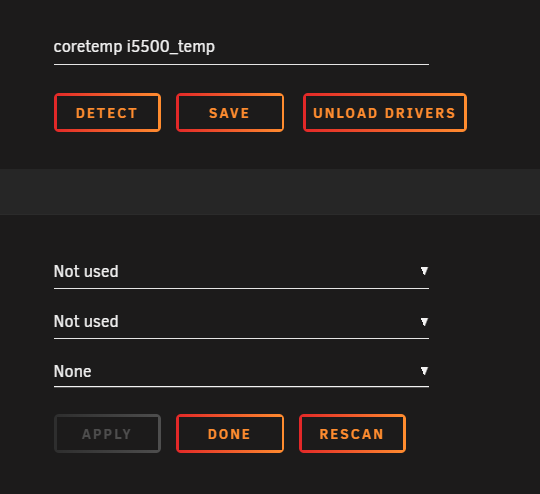

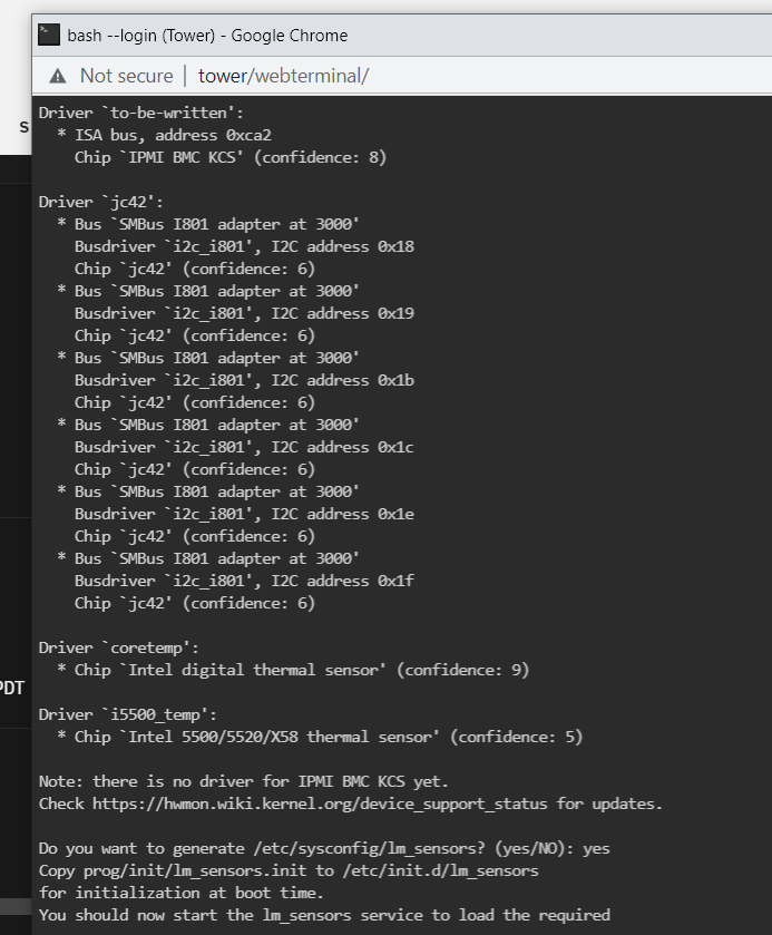

a more complete copy of the script that ran, I have stripped out the negative responses:
# sensors-detect version 3.6.0
# System: IBM System x3650 M3 -[7945D2U]- [00]
# Board: IBM 90Y4784
# Kernel: 5.10.28-Unraid x86_64
# Processor: Intel(R) Xeon(R) CPU X5690 @ 3.47GHz (6/44/2)
This program will help you determine which kernel modules you need
to load to use lm_sensors most effectively. It is generally safe
and recommended to accept the default answers to all questions,
unless you know what you're doing.
Some south bridges, CPUs or memory controllers contain embedded sensors.
Do you want to scan for them? This is totally safe. (YES/no): yes
Intel digital thermal sensor...                             Success!
    (driver `coretemp')
Intel 5500/5520/X58 thermal sensor...                       Success!
    (driver `i5500_temp')
Some Super I/O chips contain embedded sensors. We have to write to
standard I/O ports to probe them. This is usually safe.
Do you want to scan for Super I/O sensors? (YES/no): yes
Probing for Super-I/O at 0x2e/0x2f
Some systems (mainly servers) implement IPMI, a set of common interfaces
through which system health data may be retrieved, amongst other things.
We first try to get the information from SMBIOS. If we don't find it
there, we have to read from arbitrary I/O ports to probe for such
interfaces. This is normally safe. Do you want to scan for IPMI
interfaces? (YES/no): yes
Found `IPMI BMC KCS' at 0xca2...                            Success!
    (confidence 8, driver `to-be-written')
Some hardware monitoring chips are accessible through the ISA I/O ports.
We have to write to arbitrary I/O ports to probe them. This is usually
safe though. Yes, you do have ISA I/O ports even if you do not have any
ISA slots! Do you want to scan the ISA I/O ports? (YES/no): yes
Lastly, we can probe the I2C/SMBus adapters for connected hardware
monitoring devices. This is the most risky part, and while it works
reasonably well on most systems, it has been reported to cause trouble
on some systems.
Do you want to probe the I2C/SMBus adapters now? (YES/no): yes
Using driver `i2c-i801' for device 0000:00:1f.3: Intel ICH10
Module i2c-dev loaded successfully.
Next adapter: SMBus I801 adapter at 3000 (i2c-0)
Do you want to scan it? (YES/no/selectively): yes
Client found at address 0x18
Handled by driver `jc42' (already loaded), chip type `jc42'
Client found at address 0x19
Client found at address 0x1b
Client found at address 0x1c
Client found at address 0x1e
Client found at address 0x1f
Client found at address 0x2e
Probing for `SPD EEPROM'...                                 Yes
    (confidence 8, not a hardware monitoring chip)
Client found at address 0x51
Client found at address 0x53
Now follows a summary of the probes I have just done.
Just press ENTER to continue:
Driver `to-be-written':
  * ISA bus, address 0xca2
    Chip `IPMI BMC KCS' (confidence: 8)
Driver `jc42':
  * Bus `SMBus I801 adapter at 3000'
    Busdriver `i2c_i801', I2C address 0x18
    Chip `jc42' (confidence: 6)
    Busdriver `i2c_i801', I2C address 0x19
    Busdriver `i2c_i801', I2C address 0x1b
    Busdriver `i2c_i801', I2C address 0x1c
    Busdriver `i2c_i801', I2C address 0x1e
    Busdriver `i2c_i801', I2C address 0x1f
Driver `coretemp':
  * Chip `Intel digital thermal sensor' (confidence: 9)
Driver `i5500_temp':
  * Chip `Intel 5500/5520/X58 thermal sensor' (confidence: 5)
Note: there is no driver for IPMI BMC KCS yet.
Check https://hwmon.wiki.kernel.org/device_support_status for updates.
Do you want to generate /etc/sysconfig/lm_sensors? (yes/NO): yes
Copy prog/init/lm_sensors.init to /etc/init.d/lm_sensors
for initialization at boot time.
You should now start the lm_sensors service to load the required
kernel modules.
Unloading i2c-dev... OK

  • Today has been a productive day   I have updated several Dynamix plugins, mainly bug fixes. Please check your plugins to get the updates.
your fans are controlled via the IPMI BMS KCS, but there is NO driver for it currently. so you cannot control your fans via the fanspeed plugin!

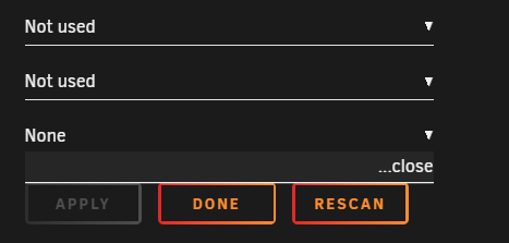

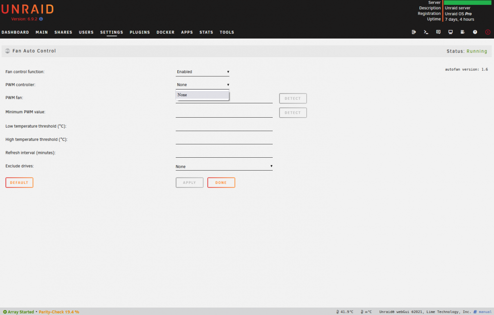

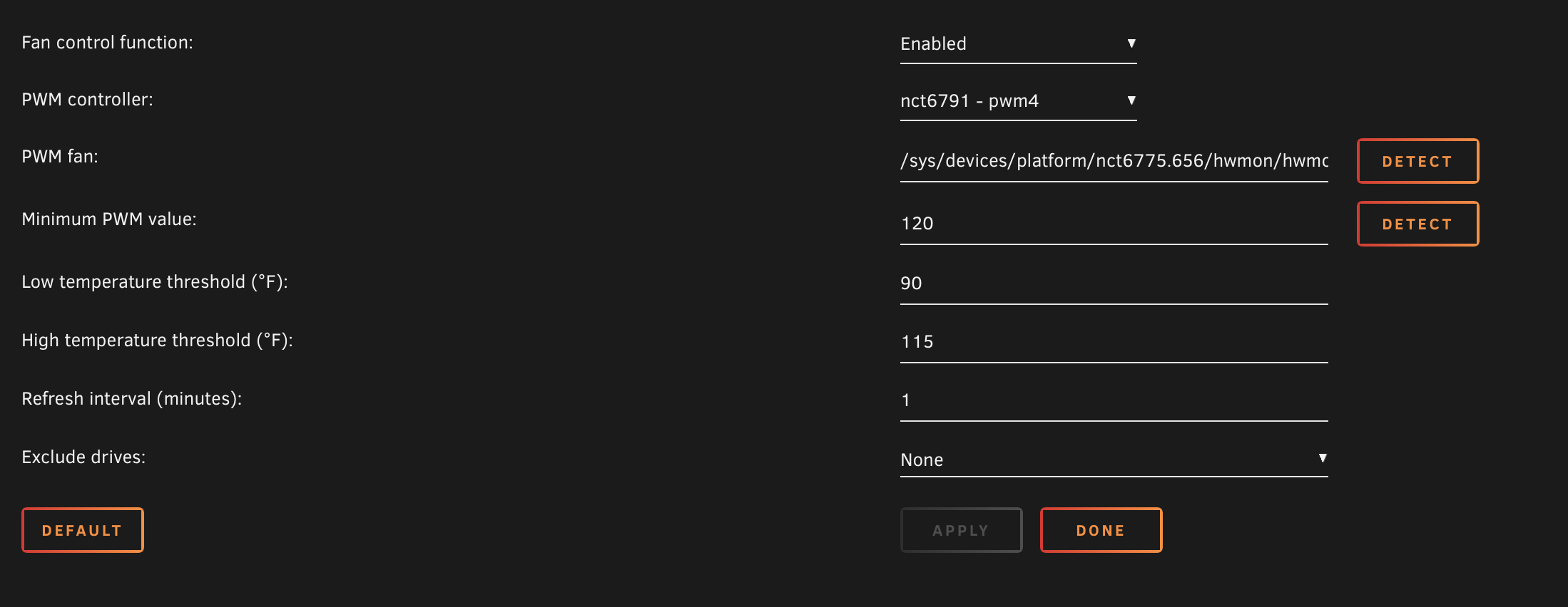

I'm also having trouble with my motherboard and the AutoFan plugin not being able to detect a PWM controller.
My motherboard is a MSI X470 Gaming Pro Carbon. I appreciate that this is a work in progress, but is this something that can work or might ever be able to work? Thanks 🙂
SOLVED - had to reboot the Unraid server for something else, after reboot the PWM controllers are listed and the airflow data shows on the dashboard. Weird.
Edited by TangoEchoAlpha
Reboot sorted it

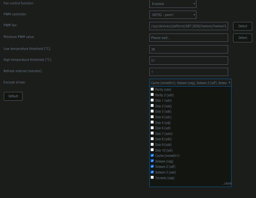

I have a Gigabyte GA-Z87X-UD3H inside a 24 HDD chassis with 3 middle, 2 back and 2 cpu fans.
The fans are connected as follows:
- CPU_FAN: cpu fans 1-2
- CPU_OPT: back fans 1-2
- SYS_FAN3: middle fans 1-3

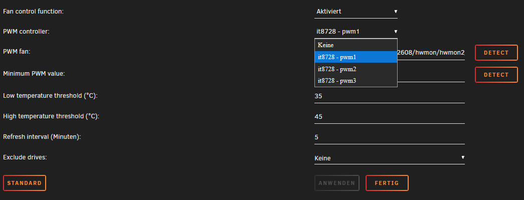

When I installed Unraid several months ago, I tried to manually setup this to auto control the fans but it seemed not to detect everything correctly (not sure, atm) and I found out that the dynamix plugin is or was based on this manual setup but with several tweaks/bugfixes, I guessed. So, I have installed the plugin (without removing anything I did before with the manual setup) and wondered which sensors etc. are correct. So, I sat next to my open server and looked while checking the settings.
- PWM Controller it8728 - pwm1: active, /sys/devices/platform/it87.2608/hwmon/hwmon2/fan5_input
- PWM Controller it8728 - pwm2: inactive, none detected
- PWM Controller it8728 - pwm3: active, /sys/devices/platform/it87.2608/hwmon/hwmon2/fan4_input
So, it looked good, the disk temperatures were around 32-43° C.
Now, I have received the several warnings by mail, the disk temperatures are up to 55° C (!!!) and after looking inside the server, there are 3 fans that are not active:
- 1 of the cpu fans
- 1 of the back fans
- 1 of the middle fans
This is especially strange as all of these fans are not connected solely but with a fan that works.
So, what is wrong here? How can I check?

Now, I manually activated PWM Controller it8728 - pwm2 without corresponding fan (as none is detected) and the log shows:
Jun  6 11:19:19 godsbane ool www[32242]: /usr/local/emhttp/plugins/dynamix.system.autofan/scripts/rc.autofan 'start'
Jun  6 11:19:19 godsbane autofan: autofan process ID 406 started, To terminate it, type: autofan -q -c /sys/devices/platform/it87.2608/hwmon/hwmon2/pwm1 -f /sys/devices/platform/it87.2608/hwmon/hwmon2/fan5_input
Jun  6 11:19:19 godsbane autofan: autofan process ID 443 started, To terminate it, type: autofan -q -c /sys/devices/platform/it87.2608/hwmon/hwmon2/pwm2 -f /sys/class/hwmon/hwmon2/fan1_input
Jun  6 11:19:19 godsbane autofan: autofan process ID 483 started, To terminate it, type: autofan -q -c /sys/devices/platform/it87.2608/hwmon/hwmon2/pwm3 -f /sys/devices/platform/it87.2608/hwmon/hwmon2/fan4_input
Jun  6 11:19:25 godsbane autofan: Highest disk temp is 53C, adjusting fan speed from: 70 (27% @ 0rpm) to: FULL (100% @ 0rpm)
But this changed nothing - the 3 fans are still not working. By the way, all fans have been brought together.
I will shutdown the server after the mover is done and will observe, if those fans are working when I reboot.
Edited by tardezyx

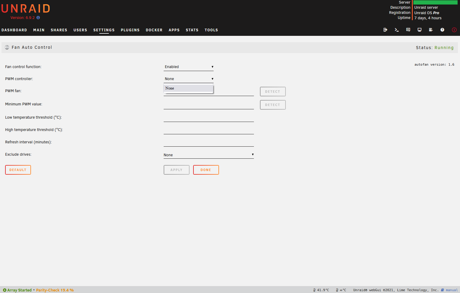

The fan control plugin will only control 1 header.
Your middle and rear fans should be combined with a powered fan splitter and connecter to 1 system header and set to full speed in the bios. Cpu fans should be configured to auto in bios based on cpu temp.

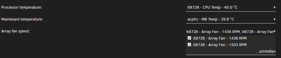

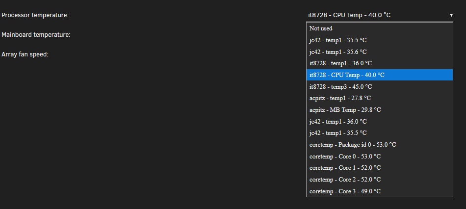

Run sensors detect, then load discovered drivers, in the fan speed plugin click detect then select the correct pwm output
After deactivating the PWM controls in the plugin and re-activating with re-detecting (the 2 it has detected before), it seems to work now, again.
It should be able to handle 3 controllers. Unfortunately, it detects only 2 here - so ye: I think I will leave the cpu fans set by BIOS only.
im telling you it only controls 1!
Nope, you can switch through the PWM controllers and set (activate/deactivate) every one of them each on their own. It even shows in your unraid system log different autofan process IDs:
Jun  6 23:34:30 godsbane autofan: autofan process ID 5315 started, To terminate it, type: autofan -q -c /sys/devices/platform/it87.2608/hwmon/hwmon2/pwm1 -f /sys/devices/platform/it87.2608/hwmon/hwmon2/fan5_input
Jun  6 23:34:30 godsbane autofan: autofan process ID 5350 started, To terminate it, type: autofan -q -c /sys/devices/platform/it87.2608/hwmon/hwmon2/pwm3 -f /sys/devices/platform/it87.2608/hwmon/hwmon2/fan4_input
Jun  6 23:34:35 godsbane autofan: Highest disk temp is 38C, adjusting fan speed from: FULL (100% @ 2265rpm) to: 189 (74% @ 1748rpm)
Jun  6 23:34:35 godsbane autofan: Highest disk temp is 38C, adjusting fan speed from: FULL (100% @ 1708rpm) to: 189 (74% @ 1662rpm)
Edited by tardezyx
2 minutes ago, tardezyx said:
Nope, you can switch through the PWM controllers and set (activate/deactivate) every one of them each on their own. It even shows in your unraid system log different autofan process IDs.
currently it only works if you have a single config file and a single controller! it's a known issue.
What!? Is there a manual for how to correctly set this up?
Driver `jc42':
  * Bus `SMBus I801 adapter at f040'
    Busdriver `i2c_i801', I2C address 0x1a
Driver `it87':
  * ISA bus, address 0xa30
    Chip `ITE IT8728F Super IO Sensors' (confidence: 9)
Driver `coretemp':
Do you want to generate /etc/sysconfig/lm_sensors? (yes/NO): Y
kernel modules.
Now, how do I proceed?

from command line run "modprobe jc42 it87 coretemp" or install the system temp plugin and the neardpack and from neardpack install pearl, the in the system temp plugin click detect
I had already installed the temp plugin, nerdpack and pearl and clicked detect which now still shows me this:

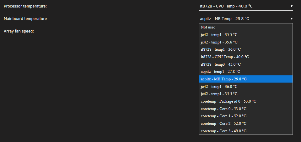

I am not sure about the correct sensors (if I remember correctly, I had once renamed those "CPU Temp" and "MB Temp" sensors a while back - i think, remembered wrongly 😄).
In Fan Auto Control I have these options:
I guess, I need to open the case and connect back & middle fans to one MB fan connector, as you said, and then just try & error which one of these three is the correct one. Is this correct?
Edited by tardezyx

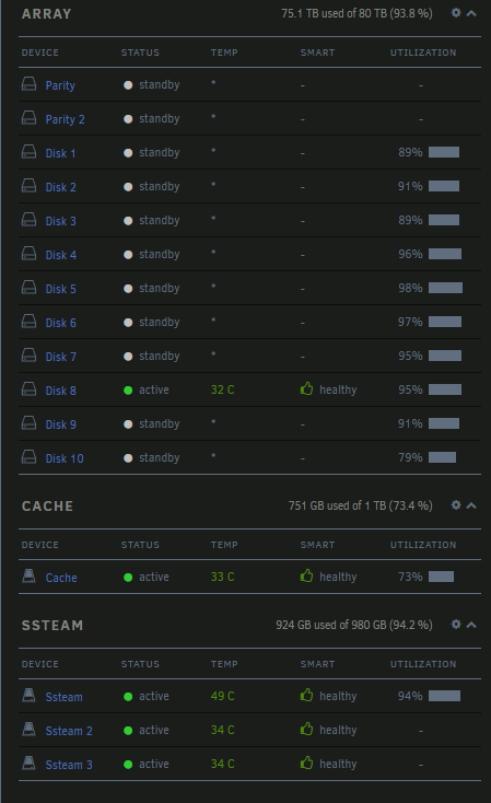

I'm having trouble with autofan as well, all seems to be working fine, but even though I exclude the ssd, it's still being reported as the device with the highest temperature, and thus the fans stay at 100% at all times.
The device in question is placed in a pool with other ssds.

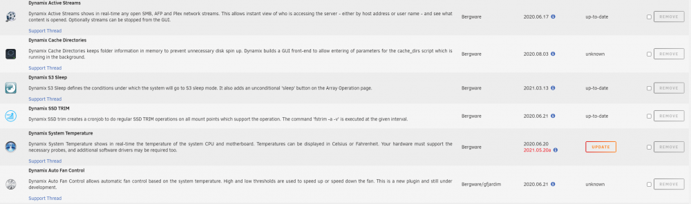

I am having a heck of a time getting Dynamix Auto Fan to behave the way I would like.  I need to get a fresh start of using it.  I have done so much trial and error with settings a script editing that its became a bit convoluted.  What would be the best process to totally erase the app from my Unraid server and be able to download and start fresh?  I feel there are config files and scripts spread all over the place and I cant begin to understand what needs deleted and what can stay at this point.
Uninstall the plugin, and if anything is left in /config/plugins/dynamix.autofan delete it.
Ok thanks.  I will go ahead and do that.  Anything in the Go file that will need manually removed?
