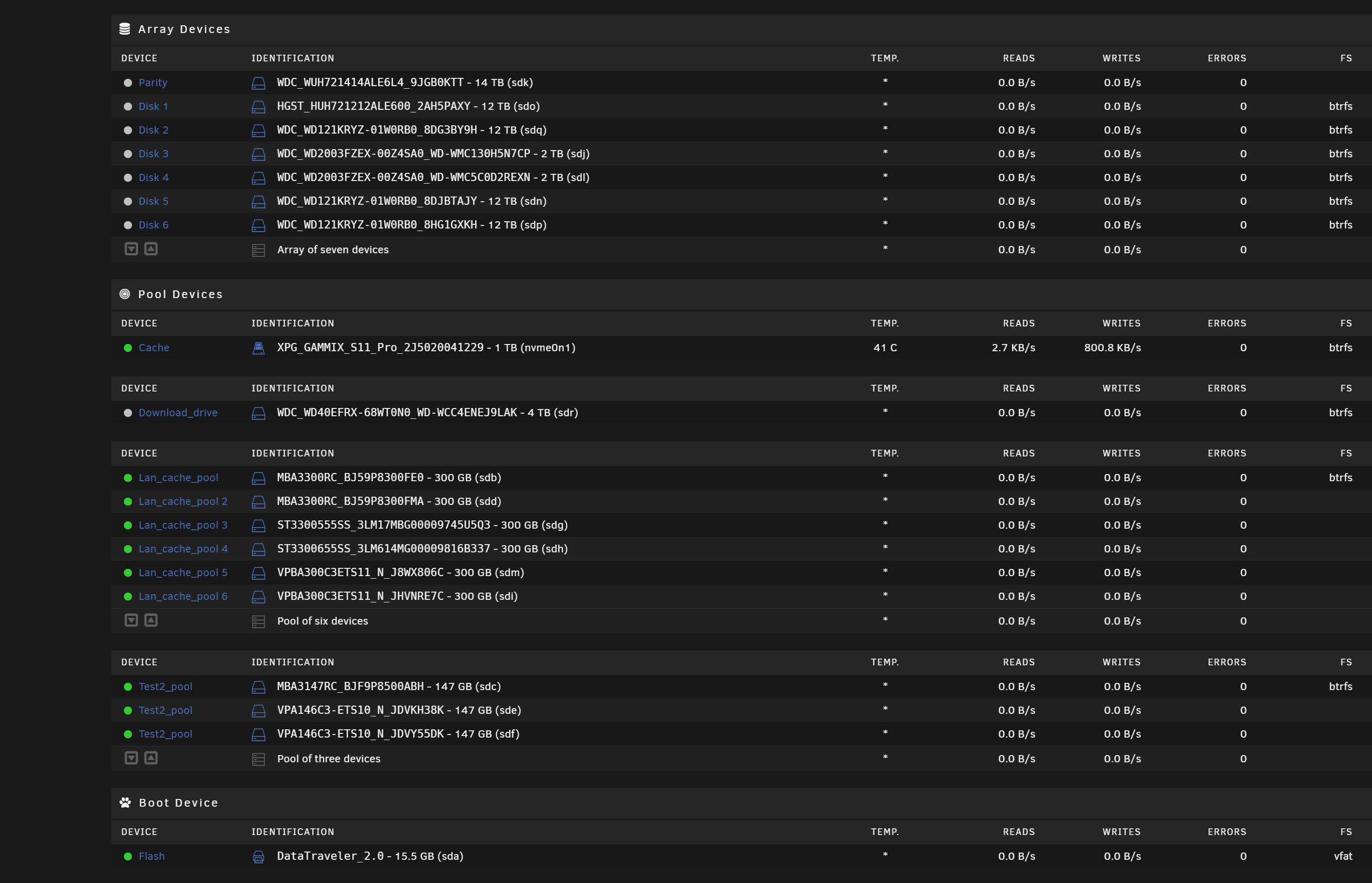

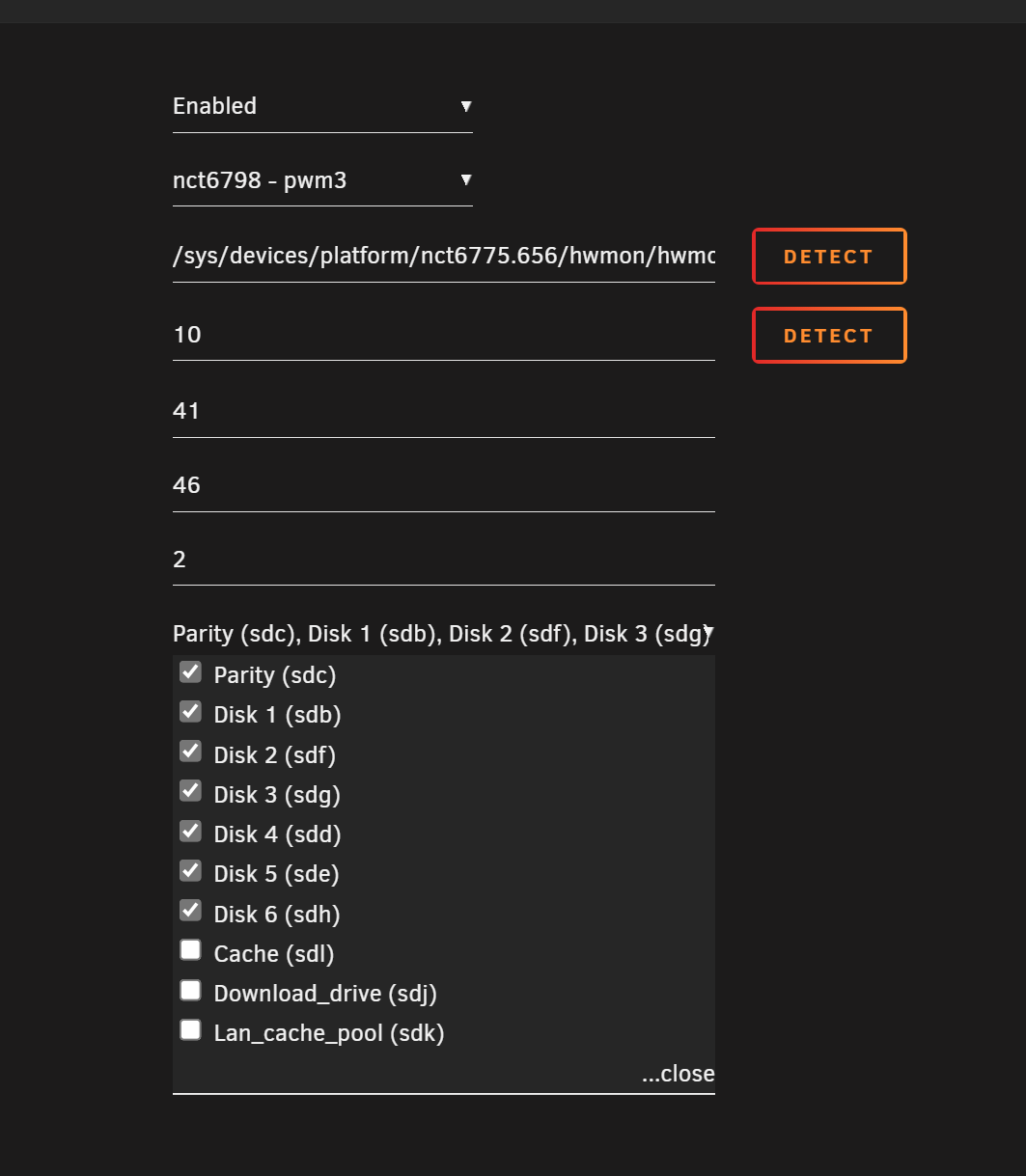

found bug in the Fan control..
if you have a bunch of drives.. and say 6 in the cache pool..  and you set the Exclude  those cache drives.
when you remove those disks..  the Excluded Disks are now the Array Disks..  so seems everytime you change a Disk in the array  either adding or deleting  a disk  .. in array. or caches.  it messes up the chex boxs..   as i find my 1 array fan running when shouldnt etc..
also  it be nice to slap a label for each fan
like  PWM1     have option to give lable   like  REAR FAN Right
PWM2 = REAR FAN LEFT
PWM3 = CPU FAN
and so on.
also   be nice when you put the mouse over top of the footer of the webpage  where it displays the Fan speeds.. instead of saying they are all Array Fans which they arent.. be nice to mouse over say CPU FAN, REAR FAN LEFT..
there was another issue i found but i cant remember now.. but figured i mention and request the LABEL option as i cant ever tell whats PWM1 - PWM7   without labeling
label be great
so in the pics ..  i dont have what i had checked off
but lan_cache_poolold   and test_pool   were  part of the excluded  with cache and lan_cache_pool
i removed all the drives in  lan_cache_poolold and tes_pool   and then you see what you see in fan control
it takes those excluded disks and set it to array disks  and it unchecks  cache and lan cache pool..  when these should have stayed checked

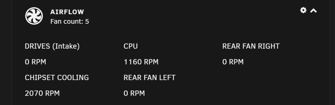

It's a bit of a kludge, but I renamed those on the dashboard using the Theme Engine plugin with some javascript.
document.addEventListener("DOMContentLoaded", function() {
    $( ".fan_view td:contains('FAN 0')" ).text("DRIVES (exhaust)");
    $( ".fan_view td:contains('FAN 1')" ).text("DRIVES (intake)");
    $( ".fan_view td:contains('FAN 2')" ).text("CPU");
    $( ".fan_view td:contains('FAN 3')" ).text("CASE (rear)");
    $( ".fan_view td:contains('FAN 4')" ).text("NVMe / PCIe");
Yeah, would be cool if those were nameable in the plugin itself, though.

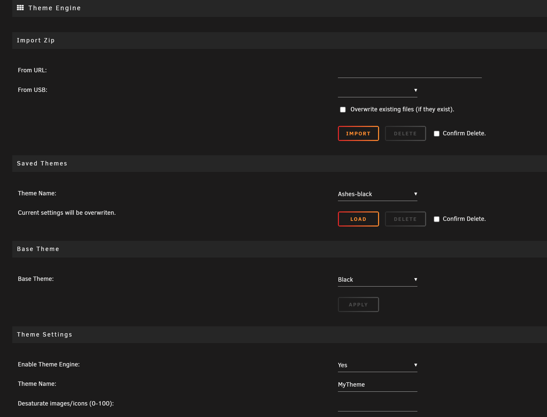

@SiteAssemble  well for being new your smarter then me lol.  i didnt know you could modify it.. but i dont really do css stuff anymroe 20 yrs ago using dreamweaver for webpage but that was it lol.
so what i did is  i just copy your code   and made a custom.css  one the flash drive.  and paste it..
but going to the dashboard it didnt run it.. do you have to reboot unraid   to get that custom to work
i tried the import button  but it does nothing and the click from usb  does nothing either
Edited by comet424

Is Theme Engine enabled? Settings > Theme Engine > Enable Theme Engine (YES)
EDIT: Also, forgot you need to enable 'Advanced View' under 'Theme Settings' - then set 'enable custom.css' to Yes
Edited by SiteAssemble
Link to comment
@SiteAssemble ok that worked  i didnt see that advanced thing..  i probably did it before you edited your post.. least i can see i can change the Fan names lol..  i never knew you could do that.. must been hard to figure it out.. well unless you work with css  alot then people know it....

So look at the attached image. This is what it looks like without the javascript. What you're doing is replacing the text marked "FAN 0" (or whatever yours is called) with the new label.  So...
... means you're looking for 'FAN 0' and replacing it with the text 'DRIVES (exhaust)'
Make sense? You have to match YOUR old labels, not mine, since they may be different.  If you still need help, PM me so we don't take up more space in this thread.
Link to comment
