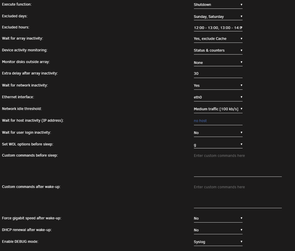

Hi all,
I've installed the Dynamix Sleep plugin having configured as such:
But it's not shutting down the server but instead keeps looping on "Initialize TCP activity counter".
Has anyone seen this before? What can I do to resolve this?
FYI: Sleep function (or Plugin) under unraid 6.10.1 not working properly.
I did a Bug report but some told me, thats not a unraid-problem...
Description of the problem:
Under unraid 6.10.1, the server went to sleep as normal - no problems so far.
After a wakeup, nothing is reachable... no ping, no GUI, no SSH.
Only a poweroff and a reboot bring the server back to life.
The problem:
Electricity costs increased to 50 eurocent/kWh and this Sleep-function is essential!
So i reverted back to 6.9.2
Edited by Zonediver
The problem:

EDIT: There is an other problem:
When the server boot up, it is necessary to send all disks to standby "by hand".
If i dont do this, the server never went to sleep or in this case did not shutdown...
So a shutdown is not an option.
Edited by Zonediver

Thats not the point...
After a reboot, all disk are active, and then went to "idle" and not "standby" - and if the disks are only "idle", the server is doing nothing.
But you NEED the status "standby" to send the server to sleep or shutdown...
I tried this several times... only a manual "push the button <spin down>" sends all disk to "standby".
This propblem exists since more then 5 or 6 years and isn't fixed... and i guess will never been fixed...
And this happens "always after a reboot".
So after "every" reboot, you have to push this f.... button "only once" to send the disks to "standby" - then all is working...
If you know a script, which can do this "push the button" trick, let me know 😉
Edited by Zonediver

...because the auto-shutdown is not working, if the disk are all "idle" and not "standby"...

Thats not what i need...
My "need" looks like this:
If all disks are spun down, send the server to sleep or shutdown.
A specific time is not helpful because a lot of family-members outside are watching Plex - so i cant shutdown at a specific time...
And THAT is my problem! With the sleep plugin and v6.9.2 all is working fine, with 6.10.1, nothing works anymore...
Edited by Zonediver
