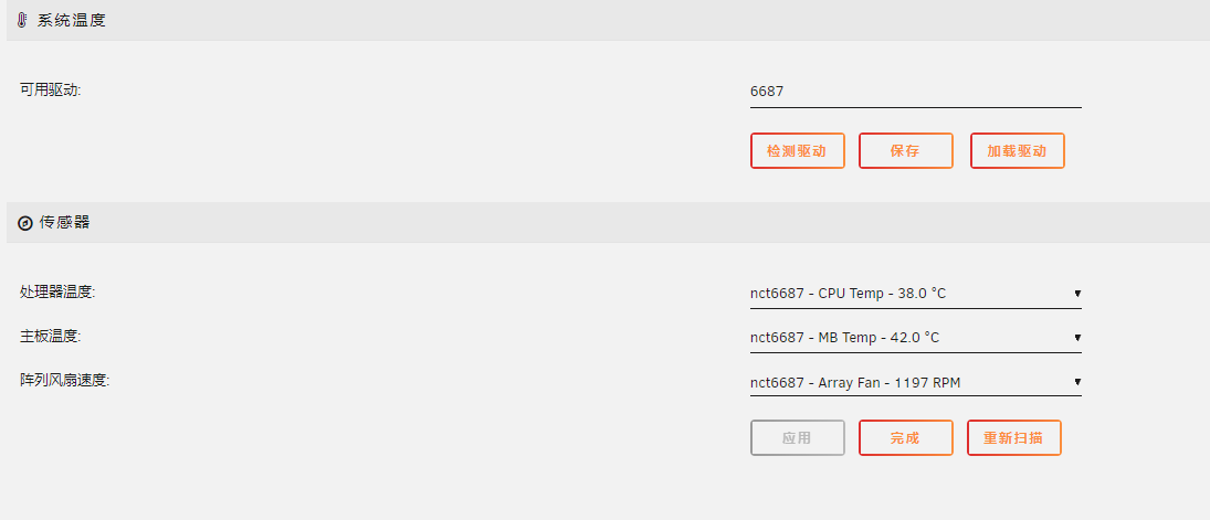

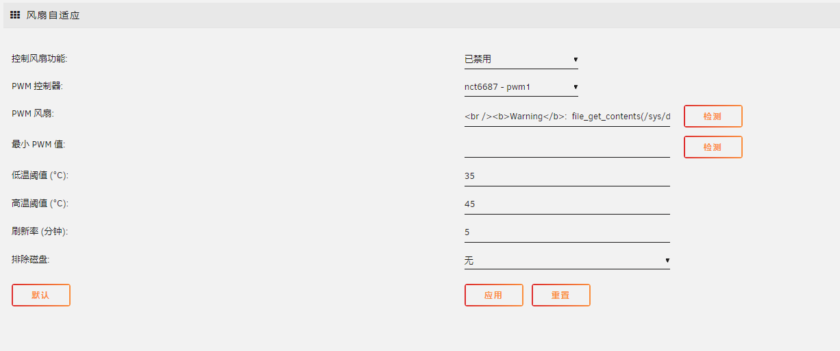

Hello, I have a problem with my nas, the autofan plugin reports an error:
<br /><b>Warning</b>: file_get_contents(/sys/devices/platform/nct6687.2592/hwmon/hwmon3/pwm1_enable): failed to open stream: No such file or directory in <b>/usr/local/emhttp/plugins/dynamix.system.autofan/include/SystemFan.php</b> on line <b>40</b><br /><br /><b>Warning</b>: file_put_contents(/sys/devices/platform/nct6687.2592/hwmon/hwmon3/pwm1_enable): failed to open stream: Permission denied in <b>/usr/local/emhttp/plugins/dynamix.system.autofan/include/SystemFan.php</b> on line <b>42</b><br /><br /><b>Warning</b>: file_put_contents(/sys/devices/platform/nct6687.2592/hwmon/hwmon3/pwm1_enable): failed to open stream: Permission denied in <b>/usr/local/emhttp/plugins/dynamix.system.autofan/include/SystemFan.php</b> on line <b>50</b><br />/sys/devices/platform/nct6687.2592/hwmon/hwmon3/fan1_input
please help me!!
my MB :msi B460M
unraid: 6.10.3
Edited by xgxxl89

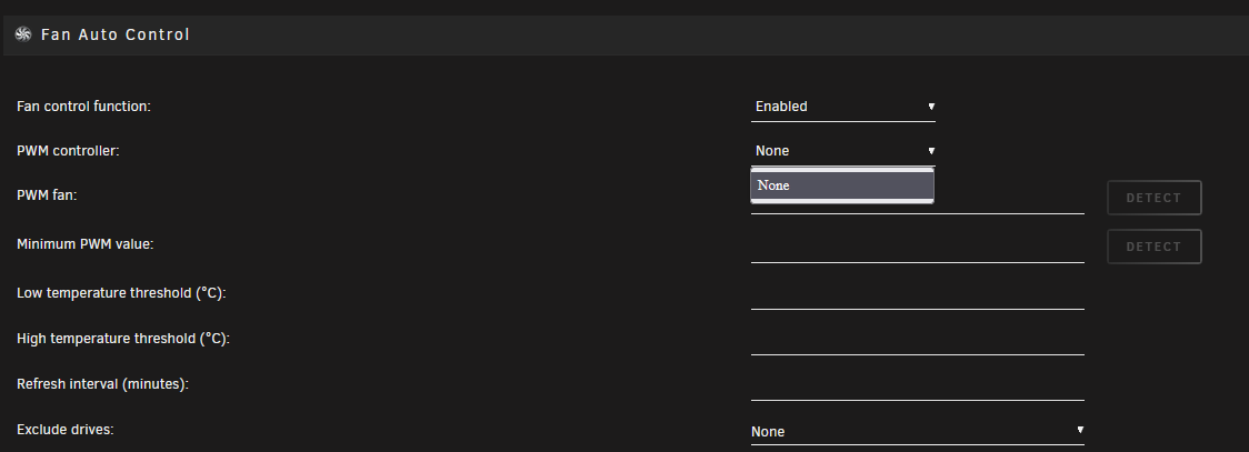

With the update to Unraid 6.11 stable, the Fan Auto Control plug-in no longer works for me. No PWM controller is recognised any more. This worked perfectly under Unraid 6.10.3.
Unfortunately, I can no longer control my fans.

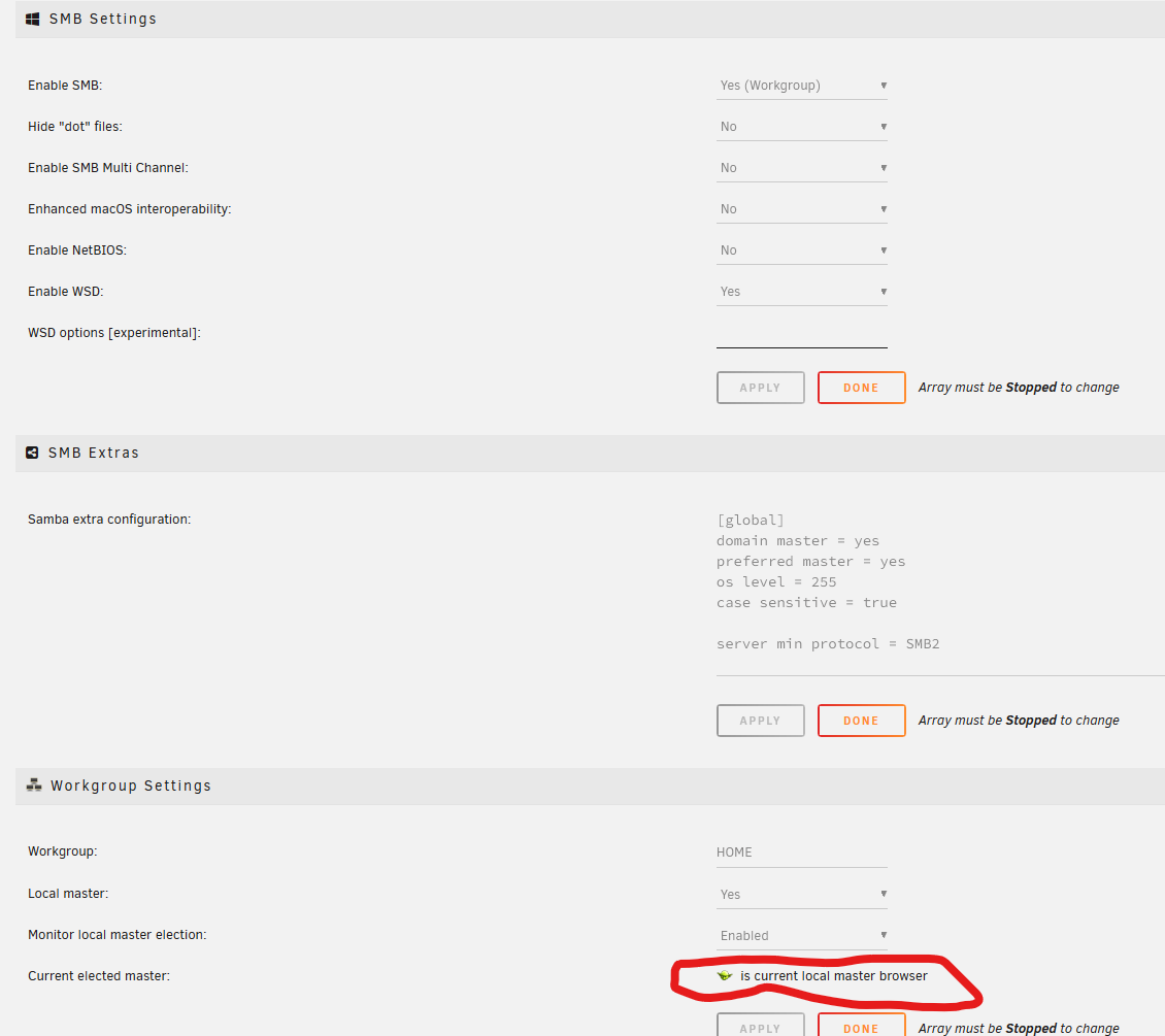

@bonienl, I am using the Dynamix Local Master plugin and the name of the Local Master no longer appears as shown below:
This server is (/should be) the Local Master.   I could show the same condition on my second server but that would be redundant as that page would be the same.  I believe this problem start about the time that I removed the last visages of SMBv1 support from my SMB configuration.
I will point out that ScottiesTech LANscaner v2.02 utility also fails to identify the current Local Master.
I also observed that the last update to this plugin was on June 20, 2020.    I am wondering if this plugin is still being supported and might receive an update anytime soon.
I had to remove this plugin because syslog was getting spammed with these
Sep  8 05:08:20 unSERVER  nmbd[6053]: [2022/09/08 05:08:20.471036,  0] ../../source3/nmbd/nmbd_browsesync.c:355(find_domain_master_name_query_fail)
Sep  8 05:08:20 unSERVER  nmbd[6053]:   find_domain_master_name_query_fail:
Sep  8 05:08:20 unSERVER  nmbd[6053]:   Unable to find the Domain Master Browser name HUGHES.LOCAL<1b> for the workgroup HUGHES.LOCAL.
Sep  8 05:08:20 unSERVER  nmbd[6053]:   Unable to sync browse lists in this workgroup.
Not a problem on the server that is (believed to be) the Local Master.  However, it was on the Testbed server.   In fact, nmbd never run the Media server while there periods where it run every few seconds on the Testbed server.  Not sure what is going on...
Edited by Frank1940

Why do I just see a YODA head with no computer name next to it when it checks for local master?
I believe that the samba function that was used to determine which server is the Local Master has been disable/removed from the current version of samba.   Another means will have to be used to determine it...
