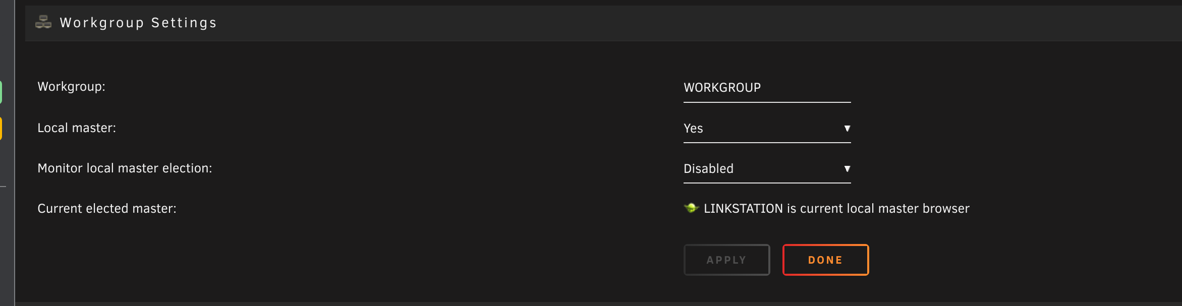

Hello
I have just added Dynamix Local Master and it has changed my Unraid Server which was the Master Server to monitor over to an old LINKSTATION?
Is there a way to change it back?

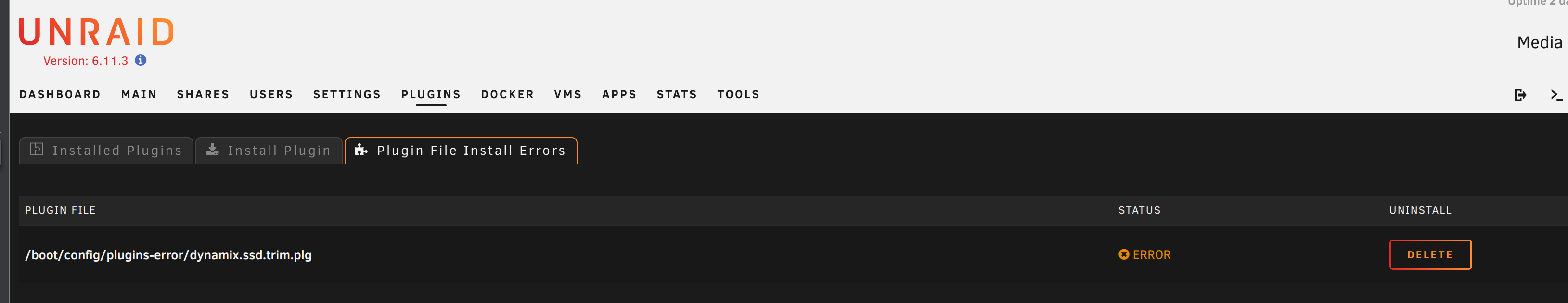

How do i fix this issue it is no longer showing as installed Trim Pluggin
The SSD trim function is now a part of the standard Unraid installation.  To check to verify that you are on a release that includes it, go to     Settings   >>>>  Scheduler  and look for the section called "SSD TRIM Settings".

16 hours ago, OsoPolar said:
Hello
Which device actually IS the local master is a subject to arcane negotiation at the network level and outside a users direct control.   I would suggest that you power off the device that is currently being reported as the Local Master and wait until it is no longer the case (which can take some time) before powering it back on.   Having said that there may be a setting on the Linkstation where you can tell it NOT ever try to become a Local Master.
20 hours ago, OsoPolar said:
Hello
For years, I  have added the following parameters to the config/smb-extra.conf   file to assure that my Unraid server ends up being elected as the Local Master:
[global]
# domain master = yes
preferred master = yes
os level = 255
@itimpi alluded to the time required to changes to occur in a SMB network.  Here is a link to an Microsoft article about the actual times:
        https://learn.microsoft.com/en-us/previous-versions/windows/it-pro/windows-server-2003/cc737661(v=ws.10)?redirectedfrom=MSDN
I know the article is old (2009) but I don't believe anything has really changed since then that would affect these times.  After you read it, you will probably be wondering two things.  First, how does this Kludge of a system ever operate with any type of reliability and, second, why are the times so long?  Basically, the whole system was initially designed to work under Windows for Workgroups 3.1 and the Intel 386-20MHz CPU was the King-of-the-Hill.   (Back in those days, typed characters would stop appearing on the monitor if a disk write operation would occur...)  Until about two years ago, one of those Windows for Workgroups computers would have worked on a SMB networking setup.

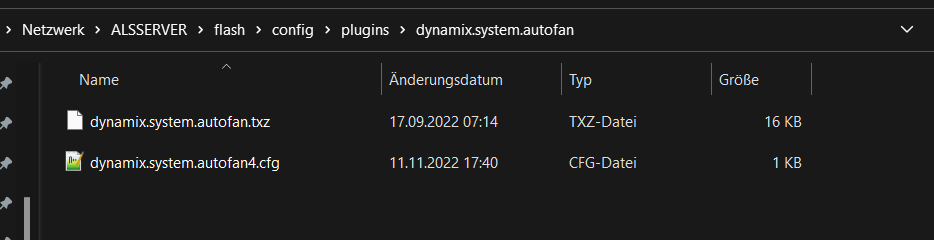

may a question about auto fan control, when i reboot the one setted up autofan doesnt autostart, i always have to adjust a value and  save to get it running, is this by purpose ?
when i remember correctly it worked before, but somehow ... 1 config file
and i think service="1" should be correct ...
options="-c /sys/devices/platform/nct6775.672/hwmon/hwmon4/pwm5 -f /sys/devices/platform/nct6775.672/hwmon/hwmon4/fan5_input -l 30 -t 20 -T 45 -m 5 -e nvme0n1,nvme1n1"
service="1"
controller="/sys/devices/platform/nct6775.672/hwmon/hwmon4/pwm5"
fan="/sys/devices/platform/nct6775.672/hwmon/hwmon4/fan5_input"
pwm="30"
low="20"
high="45"
interval="5"
exclude="nvme0n1,nvme1n1"
may an idea what i ve done wrong ?

Hello Guys,
i have a problem with the Plugin. After i set the Array fan speed a lost all sensors and can not set only cpu and mainboard.
unload und load k10 not work. Deinstallation von Plugin und new Installation give no solution.
Any Idea?
4 hours ago, Bluppylein said:
Hello Guys,
Any Idea?
i have delete all information in sensors and it work

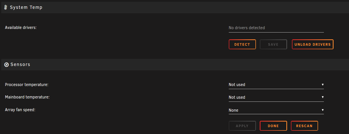

Hey guys, i am running Unraid 6.11.5 and just switched to Ryzen 7000 and now i cant see my temps anymore through the temp plugin?
I just shows "not drivers detected" when i click detect. It recently worked on my older plattform. Anything i can do there?
